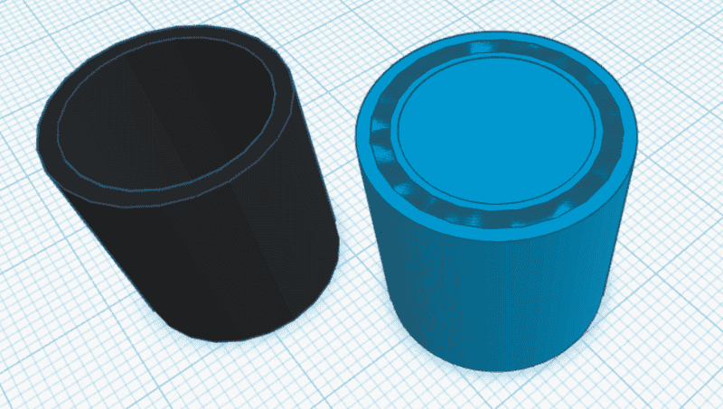

I plan to build the inductor myself, so I do not have a datasheet for it. I am going to create a 3D printed mold to wrap and compress the copper windings to form an inductor. Then I will make another mold with a different circumference to form another inductor. Both inductors would have the same number of turns and wire gauge.
Good for you. That is very creative, and a good project to learn from.

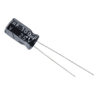

How do I check to see if the capacitor is non-polar? It is from a Freenove electronics kit I have and it looks like this:

That is a polarized Cap and not suitable for the application

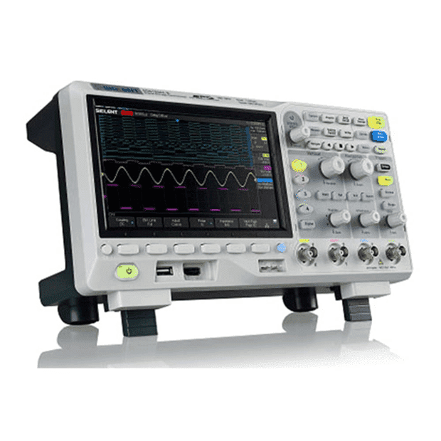

I bought this oscilloscope and I am hoping it was a good investment:
Can I create my own non-polar cap then?
You want as non-electrolytic cap. I will let the experts tell you which. There are good ceramic caps available.
The scope looks just fine. Have you played with it yet?

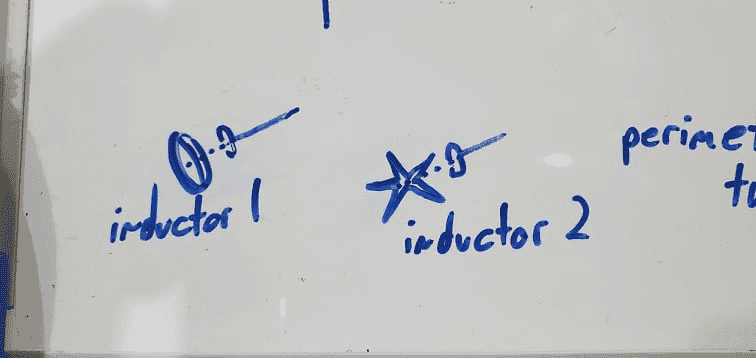

The research question I came up with is: If two inductors have the same perimeter and the same number of turns (thus made up of the same length of wire) but different shapes, will the inductance be equal?
My hypothesis is that they will not be equal because the cross-area section is different between the two shapes.
My first hurdle was to determine how I can have two shapes equal in length and perimeter. My answer to this was to take a circular coil for one inductor. The other inductor will have concave angles (like the shape of a star) to shrink the circular coil while maintaining the same perimeter (length to travel around the shape).
My paper would describe the different shapes by calculating their different areas inside the shape (so the circle would be π(r)^2 and the other shape will be the sum of the area of triangles and a polygon).
My second hurdle was to eliminate any possible measurement errors. Because wrapping a wire around something by hand could cause kinks or inconsistent shapes, I decided to make a mold with my 3D printer. I will use the free website TinkerCad to do this.
I just made this just now very quickly for explanation purposes and will look 100% better once finished. Basically, that shaded area on the blue will be exactly the diameter of the wire so once I coil wire in that space it will not be able to form kinks. Also, that black piece will be used to compress the wire so that there are no spaces between the turns of the copper wire. I am going to use my calipers to find the diameter of the wire.

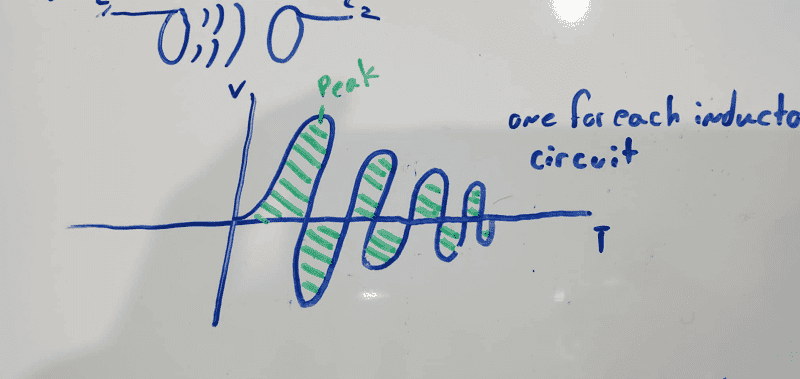

Once I have the circuit together, I well induce a voltage and see the LC tank on the oscilloscope which would look something like this picture I drew:
I will calculate the area under each cycle (hence introducing calculus concept: integrals) and sum them up for a total area. I will do this for both inductors.
I will then figure out which inductor has the greater total area and deem it more efficient because it resonates greater current before zeroing out.
I think I could just take the area under the first cycle and can conclude the same thing now that I think about it.

I read the entire manual it came with and really enjoyed seeing a signal appear on screen just to calibrate the probes. Other than this I haven't done much because I'm afraid of ruining the internal components. I wanted to finish this super long tutorial on YouTube before I begin making simple circuits with an Arduino and display them on the oscilloscope. The function generator I haven't even turned it on yet because I do not know how to use it.
@AspiringEEngineer I realize you have now decided to use the function generator but the thought of a homemade coil and that 25 Volt polarized electrolytic capacitor hooked to the 120 volt line which was your previous intent really makes me question if you should be doing any of this without some actual guidance from someone in addition to the people on this forum.
