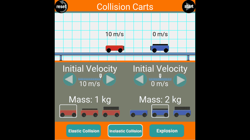

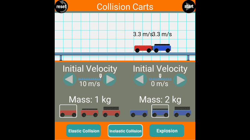

Guys, I'm confused that how momentum is conserved when kinetic energy is lost?...I know this question is asked by many people and i searched for it but I'm not getting the reason. Here i have sent two photos which shows that momentum is not conserved from www.simbucket.com. If I am wrong at any point please correct me. Thankyou

The 3.3 m/s is rounded up. It's actually 3.333... m/s.
But still its not equal right?I don't think that approximations should be taken
If you cannot interpret numerical results, do the symbolic math yourself.

You have just confirmed my suspicion about using simulations to 'prove' ideas in Science. The difference you think you have found is just because of the inevitable rounding in the calculations.
First of all, believe that Momentum is Conserved, which as been proved by measurement, time and time again (and to greater and greater accuracy). A simulation is not a measurement. Then stick with the 'algebra' to get answers - putting in the numbers at the very last moment.

I'm sure the issue here in not calculation accuracy, but merely screen space.

3.3 is the approximation displayed by your simulation. 3.33333333... (or ##3 \frac{1}{3}##) is the exact value. Substitute that exact value into the calculation for the total momentum in your first diagram (the final state after collision) and you'll see that it does follow conservation of momentum.

Yes and no. The display was rounded more than we might like but, otoh, that sort of confusion would never occur in a symbolic approach. The fact that the OP actually thought he might have found a 'loophole' due to the results of a simulation is worrying. (Not his fault but the fault of the common belief in simulations.)

It's actually not quite right to say that the kinetic energy is "lost" - it's more that some of the kinetic energy goes somewhere else where we aren't counting it. In the example you started with, a 1 kg cart traveling to the right at 10 m/s collides inelastically with a 2 kg cart at rest and they both end up moving to the right at ##3\frac{1}{3}## m/s. Momentum is conserved (10 kg-meters/sec before and after, either as ##1\times{10}## or ##3\frac{1}{3}\times{3}##) but the kinetic energy before is 50 joules (by ##E_K=mv^2/2##) but only a bit more than 16 Joules after (same formula). The "lost" energy isn't really lost - it went into the work needed to smash and deform and bend the two carts, heat from friction in the collision, maybe sound waves from the noise of the collision, various other things.
