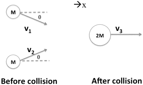

Two objects of mass M (= 1 kg) each travel with identical speed (|v1| = |v2| = 3 m/s) making an angle of θ relative to the x-axis. After they collide with each other, they travel as one object of mass 2M and with a velocity v3 (|v3| = 2 m/s) in the horizontal direction.
What is the value for angle θ in radians?
I tried m1 * v1 * cos(θ) + m2 * v2 * cos(θ) = mf * vf, but that was just a blind attempt to try something.
It's a practice exam question so I know the answer, but I want to know how to get there.

Hello Saendy. Welcome to PF !
Use conservation of momentum.
What's the momentum of the system (total momentum) before the collision?
What's the momentum of the system after the collision?
Hi Sammy, thanks for replying!
The total momentum before should be:
Pi = (m1 * v1) + (m2 * v2) = (3*1) + (3*1) = 6
The total momentum after should be:
Pf = (2m * vf) = (2*2) = 4

Don't forget v1 andv2 are vectors. Momentum is too.
