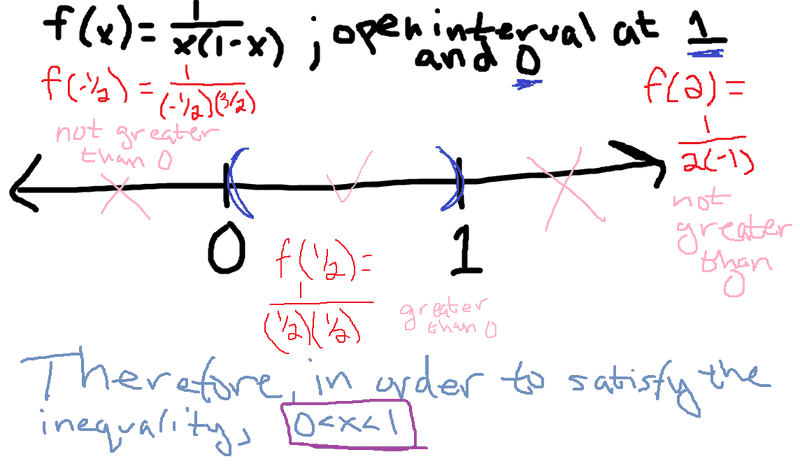

Hello folks :smile:
I always thought that inequalities could be treated exactly like equations but somehow I seem to be loosing information or something. For example, if I wish to find all values of x for which the following is true:
1/x + 1/(1-x) > 0
I would 'solve' it as follows
1 + x/(1-x) > 0
x/(1-x) > -1
x > x-1
And here is where I fail. Solving any further results in the obvious: 0>-1.
What is it that I am doing wrong that does not allow me to 'solve' for all x that satisfy the inequality. Am I wrong in thinking that I should be able to.

Here's how I would attempt this.
Combine the terms.
1/x + 1/(1-x) > 0
1/(x(1-x)) > 0
Solve for the critical points ( they're 0 and 1).
Now make a number line and test at each of the intervals (in this case, there are three) to see if they're greater than 0.
Look at the attachment.:smile: (little barbaric)
Note: closed interval at 0 and 1 due to it being undefined.

Well, first thing I would do is multiply the first term by (1-x)/(1-x) (multiplying a single term by 1 is acceptable). Now, this wouldn't work if we were working in R, but due to the restrictions on the problem, we're working in R\{0,1}*, so this is acceptable. Multiply the second term by x/x, of course.
That gets us (1-x)/(x(1-x)) + x/(x(1-x)) > 0. Combining fractions gives us 1/(x(1-x))>0. From here, multiply both sides by x, and here you'll need to split the problem into two parts. The first part, for all x>0, will simply by 1/(1-x)>0. The second part, for all x<0, will be 1/(1-x)<0. Do you see why that is?

Keep pushing through. You just need to remember to consider both positive 1-x (or x) or negative 1-x (or x) in your problem.

x/(1- x)> -1 does NOT imply x> x- 1 because if b<0 a/b> c gives a< bc. Multiplying both sides of an inequality by a negative number reverses the direction of an inequality.
And with problems like this, since you do not know what x is, you do not know whether the quantity you are multiplying by is positive or negative. The best thing to do is look at the cases.
Since you want to multiply by 1- x, you have to consider:
1) 1-x> 0 (which is, of course, the same as x< 1)
Multiplying both sides of the inequality by 1- x is multiplying by a positive number so
x> -1(1- x)= x- 1. Subtracting x from both sides give 0> -1 which is a true statement no matter what x is. That is, the inequality is satisfied for all x< 1.
2) 1-x< 0 (which is, of course, the same as x> 1)
Multiplying both sides of the inequality by 1- x is multplying by a negative number so the inquality reverses. x< -1(1-x)= x- 1 which gives 0< -1 which is a false statement no matter what x is.
