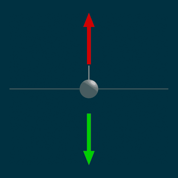

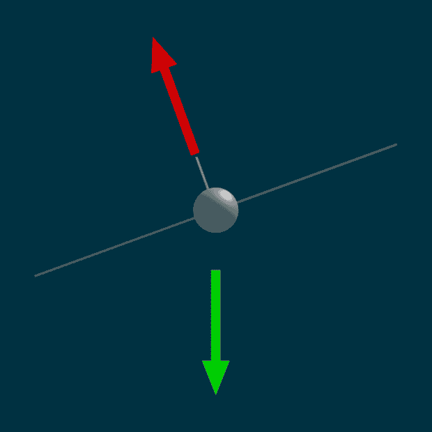

Here's a picture of an aeroplane flying straight towards you.
I've added the lift vector in red, pointing straight up, and the weight in green pointing straight down. Now the aeroplane wants to make a right turn, so it tips its wings:
The weight vector remains pointing straight down, but the lift is generated by the wings, and remains perpendicular to them. If you add those two force vectors you get a net force to the aeroplane's right (left on the diagram because the plane is coming out of the page).

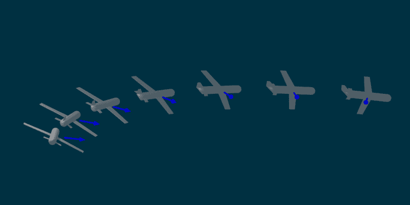

Now let's draw a sequence of images of the plane making its turn.
This time I haven't drawn the lift and the weight, just the resultant vector pointing inwards in the turn. Notice that, after the very first frame, all of those blue arrows point slightly backwards relative to the initial direction of the plane. That's the force that reduces its groundspeed in the east-west direction to zero. It comes from the aircraft's wings pushing on the air - it does not come from the engines. Their thrust is solely used here to counteract drag.

So, the plane starts to regain the lost momentum during this maneuver where the force points back to the eastward direction. Now it makes sense that I visualize it.
