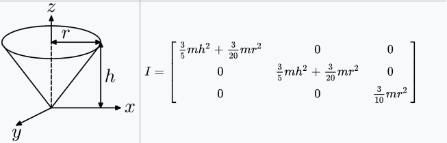

Im trying to calculate the principals moments of inertia (Ixx Iyy Izz) for the inertia tensor by triple integration using cylindrical coordinates in MATLAB.

I plug in test values in both the formulas from the image and the code and they seem correct except from Iz in which the height (h) still appears and terms like 3h-2r instead of h appear, Am I missing something in the integrations? Thank you in advance.

Did you try doing the integrals by hand? (They are not difficult.)
Please show your work in determining the integration boundaries.

In cylindrical coordinates for a solid cone the only non-trivial boundarie would be on the first integration, since its a solid of revolution, theta goes grom 0 to 2*pi and r goes from 0 to R (radius of cone).
z would go from z = r (x^2 + y^2) to z = h (height of cone)
This is incorrect and you have not really provided an argument for why it should be the case. I suggest you take a second look at it.
Likes Noxuz
Thank you, I found the error, the inferior limit of the integral for z isn't r, its (H/R) * r, The textbook I was reading gives an example for a cone of equal heigth and radius so it ignored the slope in the integral.
