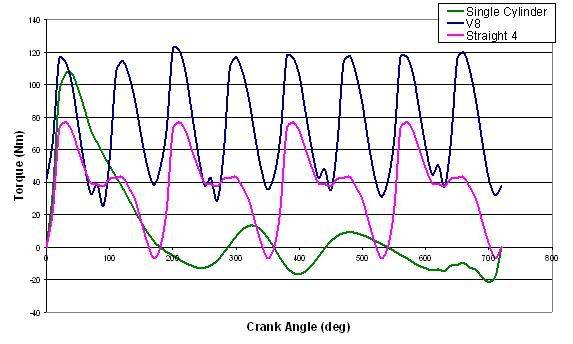

I only have a low RPM indicated torque output plot.
In this image you can see a peak in torque output at the about 20-30 deg aTDC due to the combustion force. Howver you can see that the green line moves up and down. This is due to inertia. As RPM increases these peaks will become more and more extreme.
I will try to post a second picture showing the inertia dominated cycle, if I can find it at home.
