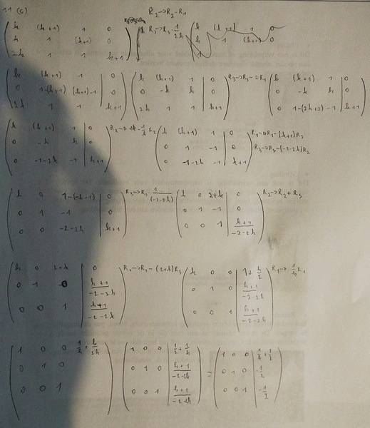

Then I thought this system had infinite solution when k =/= 0. But here I'm wrong.
Apparently if k=-1 then there are infinite solution with one free variable. However, when I plug in -1 then all solutions are -1/2.
I don't understand why this is infinite.
I did my row operations as practise.

That's not what I get. If k = -1, there are an infinite number of solutions. Check your arithmetic.
Also, it wasn't clear until well into your hand-written work that your matrix is an augmented matrix, and that the system is three equations in three unknowns. You should have included the system of equations in the problem statement of the template (which you deleted).

Check back through your working during the row reduction. Look for each place you divided through by an expression with k in it. What do you need to consider?
By row reduction, I get the augmented matrix down to this:
##\begin{bmatrix}k & k + 1 & 1 & | &0\\ 0 & k & -k & | & 0 \\ 0 & 0 & 2k^2 + 2k & | & -k^2 - k \end{bmatrix}##
Where we're going to have trouble is in the last row. The third term in that row is 0 if k = 0 or k = -1 (which you have already said).
Go back to the original matrix, and plug in k = 0, and row reduce this matrix. This should tell you that the system is inconsistent if k = 0. Again, using the original matrix, plug in k = -1, and row reduce this matrix. You should see that you have one free variable in this situation.

No. In algebra, what is it illegal to divide by?
Zero. But dividing by k is not dividing by zero?

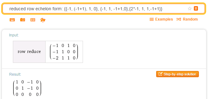

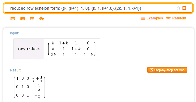

As far as I know, rewriting the system in a different form does not change the original system? But apparently it does because when k=-1 in the first image you get a free variable and infinite solutions, whereas in the second image you get one solution. {-1/2,-1/2,-1/2}

It is when k is zero.
Given an equation like x f(x)= x g(x) you should argue " either x=0 or ...".

That is not quite right: you ARE allowed to divide by k as long as k ≠ 0. So you can split things up into cases, for example:
Case (1): k = 0 ---> proceed.
Case (2): k ≠ 0 ---> proceed. Dividing by k is OK in this case.
In Case (2) you may run into further problems if k = -1, so you can have:
Case (2a) k = -1 ---> proceed; and
Case (2b) k ≠ -1 (and, f course, k ≠ 0). Dividing by k and k+1 are both OK in this case.
Sorry, I had to be more specific. I meant when there is a leading k in the matrix, just leave it as k. Don't multiply the row by 1/k just to get a one. In all my exercises I did stuff like that because Wolfram|Alpha (I use it as verification) did it also. So I applied it everywhere.
Btw, don't you mean: Case (1): k = 0 ---> don't proceed.
No, I meant "proceed", but not necessarily in the same way you would if k were nonzero. There can be several ways to proceed, depending on conditions.
