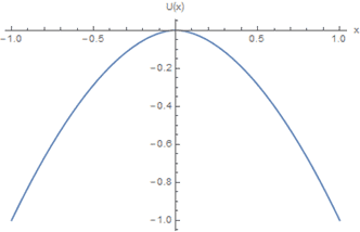

Is it possible to construct a shape of the potential energy "hill" such that the time is finite rather than infinite?
For convenience, choose the origin of the x-y coordinate system at the top of the hill. In this coordinate system, suppose the hill is described by
##U(x) = -|x|^{1.8}##. The first derivative of U exists at x = 0 with U'(x) = 0. But higher order derivatives do not exist at the origin. I don't know if this would be considered "pathological" according to @PeroK 's comments in post #8.
The graph of U(x) vs. x looks like an OK hill.
If the particle starts at ##x_1## with just enough initial speed to reach ##x = 0## with zero speed, then I get that the time to travel from ##x_1## to ##x = 0## is
t = ##10\sqrt{\frac{m}{2}} x_1^{0.1}##
