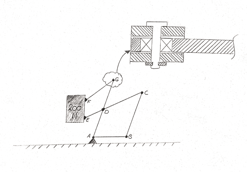

Hello,
I have a structure with 5 pivot point and those are provided with deep groove ball bearings (see sketch).
Calculation for friction losses (deep grove ball bearing):
Parameters:
- Number of pivot points: 5
- Friction coefficient: 0.0010 - 0.0015 (Reference)
Total friction in the structure: 5*0.0015*100% = 0.75%
If compared to plain bearings:
Calculation for friction losses (plain bearing):
- Friction coefficient: 0.2 (worst case, Reference)
Total friction in the structure: 5*0.2*100% = 100%
I already imagined that a plain bearing has a higher impact on friction, but this amount does surprises me. Are those assumptions and calculations done in a correct manner? Or do I miss something here?
Besides, that 100% for plain bearings doesn't seem to be realistic. Does it mean the structure can't operate/move because the it can't 'overcome' the friction? 🤔
Where is the pin radius or diameter specified ?
If the diameter of the pin can be reduced, the pressure will increase, but forces will remain the same, but the length of surface moved will be reduced. Thinner pins have less circumference, so less friction losses.

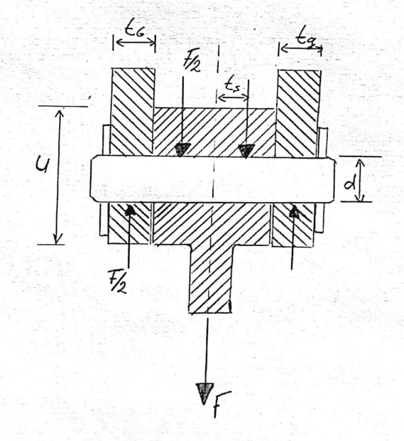

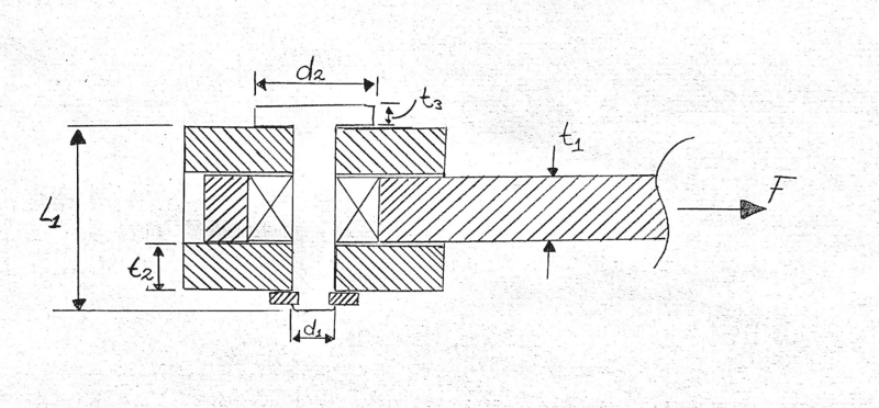

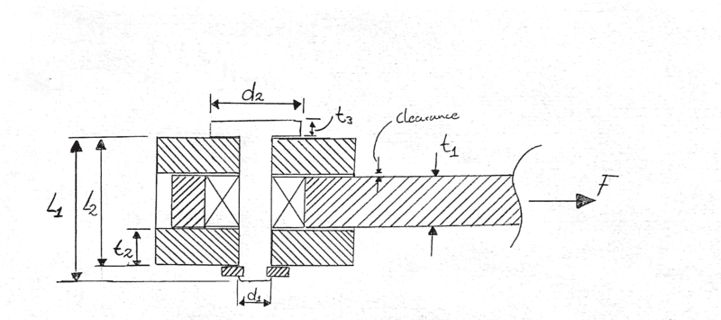

Thanks for the reply @Baluncore .

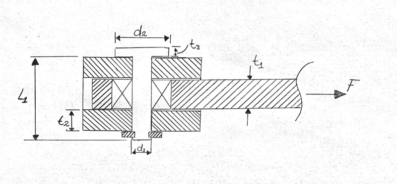

I re-drawn the sketch and added the variables. If I take the the following dimensions and the force:
  • d1 = 10 mm
  • d2 = 16 mm
  • t1 = 4 mm
  • t2=tg = 3 mm
  • t3 = 1 mm
  • L1 = 14mm
  • L2 = 10mm
  • F = 500 N
Formulas:
  • σ = F/A (this formula is meant for the 'pressure'?)
  • M,max = (F*tg)/4 (see sketch) This formula is when the rod has a tight fit and the holes a loose fit. M,max stands for: highest bended moment.
This makes the calculations:
  • σ= 500N/(phi*10mm) = 15.9 MPa
  • M,max = (500N*3mm)/4 = 375 Nmm
But what has it to do with the friction? I can't figure it out yet... o_O

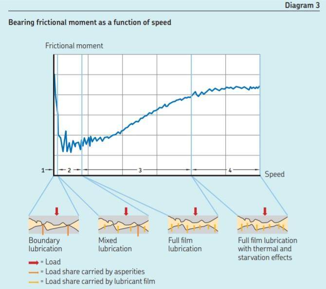

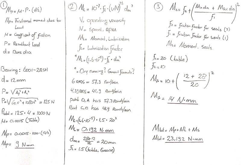

Calculating friction for your linkage is a multi-step process. There is more than one way to do it. This is how I would attack the problem:
1) Assume an angular velocity at the input.
2) Calculate the load and angular velocity at each joint.
3) Calculate the friction torque at each joint. If you are using rolling element joint bearings, the SKF bearing catalog tells how to calculate that torque: https://www.skf.com/binaries/pub12/...ngs---17000_1-EN_tcm_12-121486.pdf#cid-121486. Start on page 132.
4) Reflect the friction torque for each joint back to the input. This might require a separate FBD for each link, starting with the link farthest from the input.
5) Sum those torques at the input. That's your total friction torque.
Note that friction torque for rolling bearings is not a simple number. This figure, from the SKF Rolling Bearing catalog, shows why:
Other types of bearings have different curves.

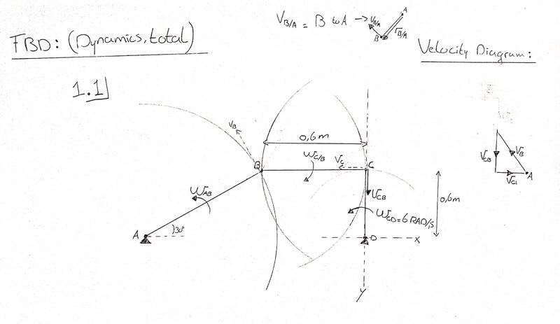

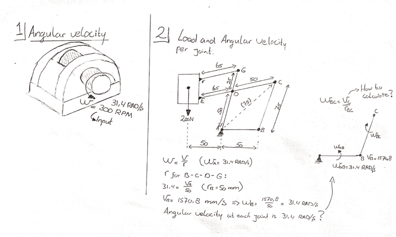

I have started with the calculation but I got stuck at finding the angular velocity for each joint. I am staring at this problem for a long time now, but I just can't figure out how to find Velocity at point C (see sketch). I have found the velocity at point B but how to bring this to point C?
Why am I missing?
Start by searching (and studying) four bar linkage and linkage degrees of freedom. Your linkage has more than four bars, but study four bar linkages first. Your linkage, as sketched, also has too many degrees of freedom to solve.
When I once designed a four bar linkage in the real world, I used an iterative numerical method, and programmed in Matlab. I could have used a spreadsheet, but wanted to simulate a full rotation, while calculating velocity and acceleration for the entire rotation. I calculated successive positions, then velocities from differences in position, and accelerations from differences in velocities.
Likes Mech_LS24
It becomes obvious when I place the coordinate origin at the point A, that without a further constraint there is no static solution.
Looking at your diagram I see the dashed diagonal line AC of length (75). Is that a suggested start point when modelling the rotational collapse about A, or is the direction of vector AB fixed somehow?
I thought this dimension was needed because it's the distance (radius) from point A to C. All the other dimensions towards the point could be founded by the dimensions of the linkages
What prevents the entire mechanism from collapsing, by rotation about point A ?
Nothing prevents the mechanism from collapsing, probably an extra 'fixed' point at B should be added?

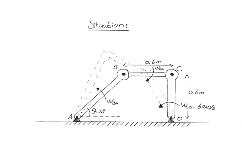

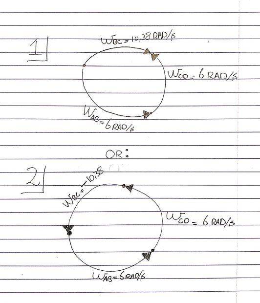

Dear @jrmichler , is this what you meant? How can friction be added to this?

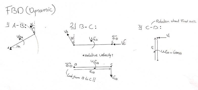

The angular velocity of each bearing is the difference between the angular velocities of the two links that are joined by that bearing. Now that you know the angular velocity of each bearing, along with load on each bearing, you can calculate the friction torque and power for each bearing.
Real world simplifying assumption: Normally external forces on a linkage are much larger than gravity and inertial forces on the links. When that is the case, simplify by assuming massless links.
Likes Mech_LS24
As I understand it, the work done overcoming friction is; θ·π·d·F·μ

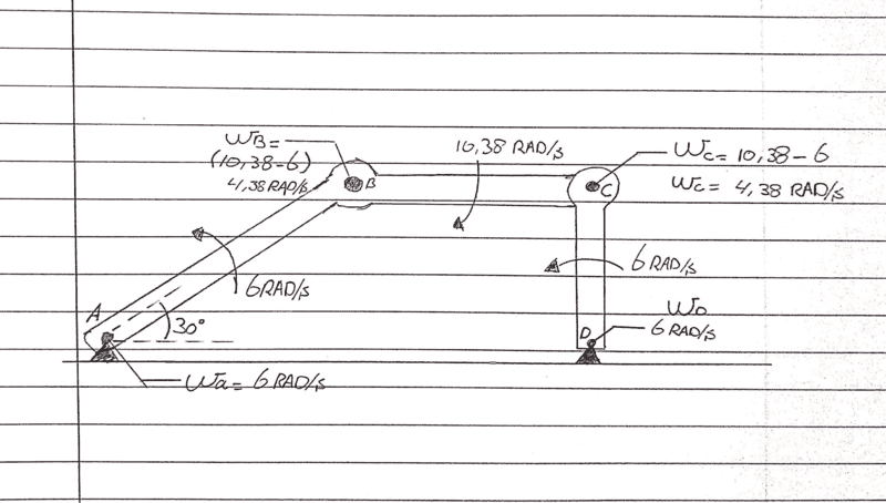

So below (figure 1) is the case right? The angular velocity at the 'fixed' support points (A & B) are the same as the angular velocities between BC and AB? Otherwise I interpret you wrong.
The loads aren't known yet? I think I should add an external force for that? Probably a load vertical (downwards) at point B?
The angular velocity at Point A is the difference between the angular velocity of link AB and the ground link AD. The ground link AD is the fourth link of your four bar linkage.
If you have no external loads, then your loads are the weights of the links.

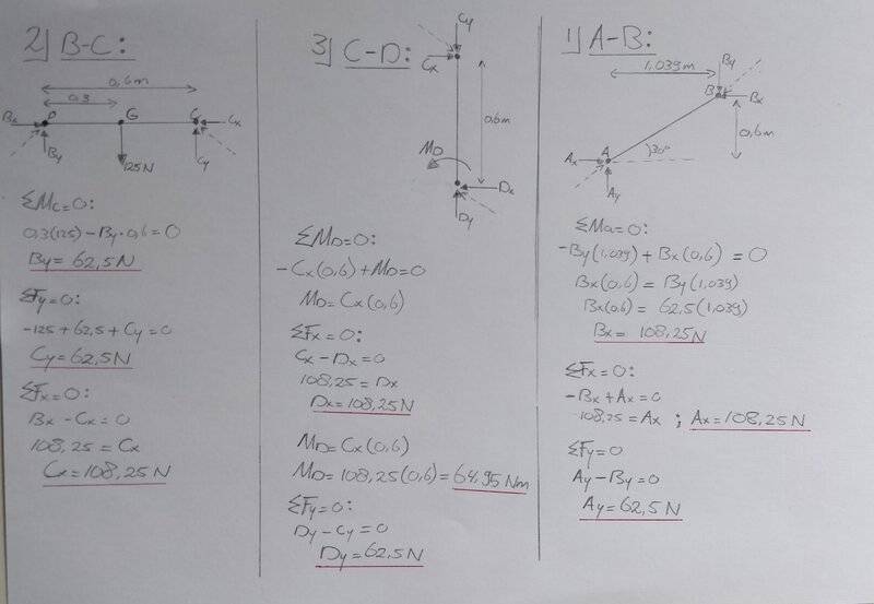

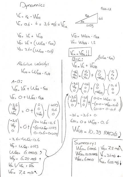

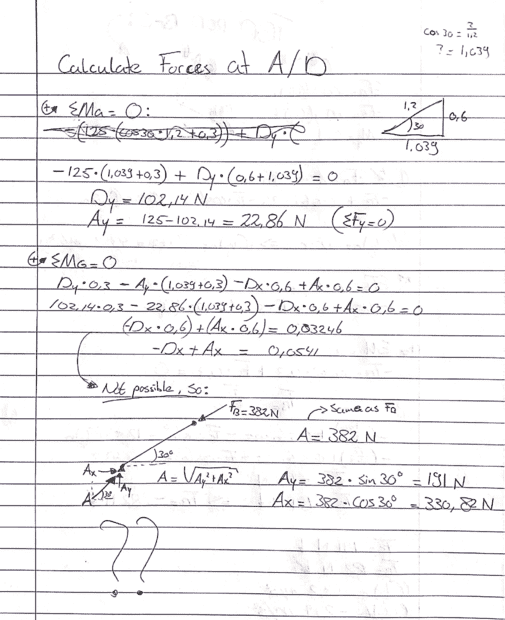

I tried to calculate the forces for each point, unfortunately I do something wrong...
For the force at point B and C I did the calculation with on a kinematic manner. After having the forces at point B and C I calculated the forces at point A and D by a normal FBD on the whole structure. The moment-sum gives me the force Ay which is 22.86 N. I checked it with a FBD for rod AB, but the force Ay should be 191 N?? o_O o_O
Hi @jrmichler , do you see any chance in the coming days help me through this process above? I am eager to dive into it :)
Thanks

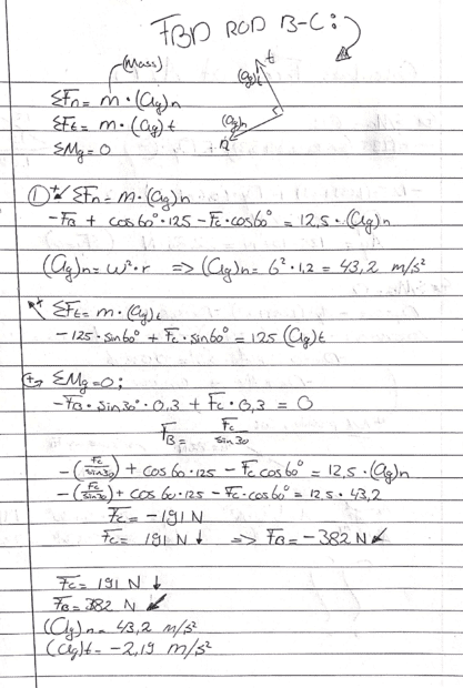

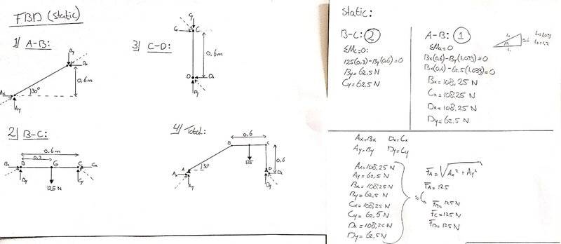

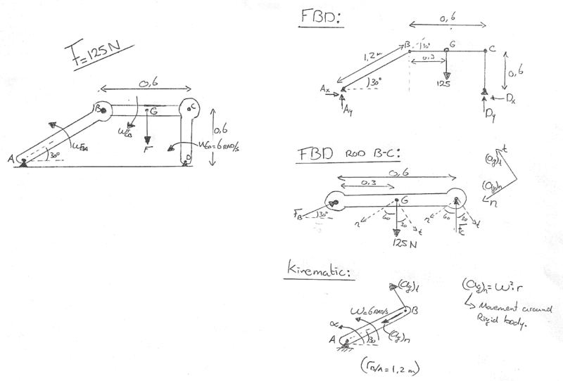

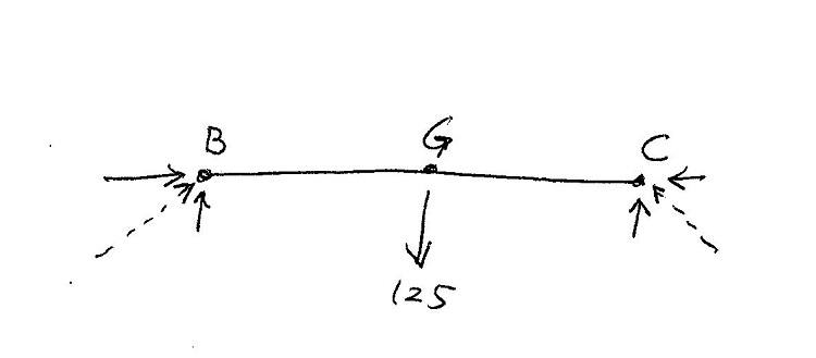

I found your calculations hard to follow, so start over. Start by showing an FBD of link BC with the X and Y force components clearly shown, along with the resultant forces. Like the sketch below, except with the dimensions, forces, and angles labelled. Do the static calculations, with separate FBDs, for all three links.
It looks like you are trying to include the effects of acceleration. If so, the next step is to calculate the acceleration of each link, and show those accelerations on a separate diagram of the entire linkage, along with the mass and length of each link. Then calculate the acceleration forces and moments of each link, with separate FBDs for each link.
Now you can sum the static and dynamic forces on each link, and show those forces on a third set of three FBDs. It's a lot of sketches - nine link FBDs plus a diagram of the complete linkage. But it will be easy to follow, and easy for you to check your work.

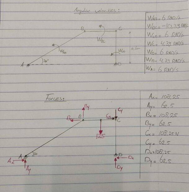

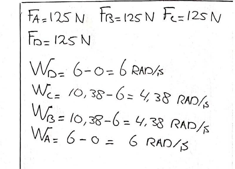

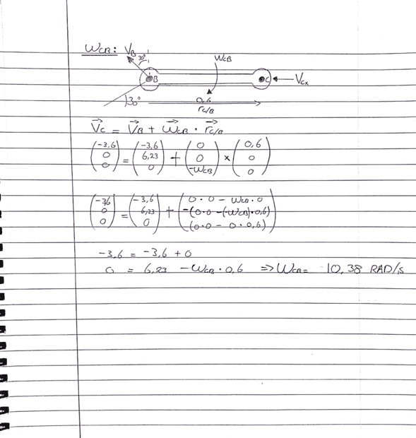

I think I got the results. In summary (pictures are attached):
Forces are:
Fa = 125 N
Fb = 125 N
Fc = 125 N
Fd = 125 N
Angular velocities:
Wd = 6 RAD/s
Wc = 4,38 RAD/s
Wb = 4,38 RAD/s
Wa = 6 RAD/s
Do these results/calculations seems correct? Or did I miss something?
Could you help me on my way to calculate the friction at each point? :)

  • #33
Numbers on the FBD's please. It's too much switching back and forth without them. The easier you make it for somebody else to follow, the easier it is to check your own work. And those other people are more willing to look into it.
Likes Mech_LS24
  • #34
Sorry, I thought you didn't prefer the numbers as you said
I have modified the sketches and add the numbers on it. Like to hear if it makes sense:smile:
EDIT: I see the pictures aren't sharp if you download them. Strange, because before attached them, they are pretty nice, even when the zoom function is used...

  • #35
https://ibb.co/SNdtmdg
https://ibb.co/MSxvNPz
https://ibb.co/6DD96S7This works better
  • #36
Let's work on the static FBD by itself. Your solution has a horizontal force at C that is not counteracted by a moment at D, so the sum of moments about D is not zero. It needs to be zero.
A good way to double check your work is by taking the sum of moments about A, B, C, D, and G. All of them must sum to zero. You only need the resultant force to calculate bearing loads.
You can embed images in the post by converting to JPG format, then using Attach files > Insert > Full image. That's the best way to do it.
Likes Mech_LS24
  • #37
I re-calculated the forces and added a moment around D, without the moment indeed, the force Cx didn't sum to zero.
Afterwards I checked the forces with the FBD and moment around A, G and B. I found a silly mistake here, I missed the force in point B and C. I thought these were internal force and therefore didn't take them into account. Could you explain when those are internal forces and how to recognize them?
The moment in D doesn't play a role in the friction as I understand? This feels strange haha.
See attached the files.
  • #38
In the case of this linkage, an internal force would be the force inside a link. Link AB, for example, has an internal compressive force (and stress). In a linkage, the forces at each pinned joint are external forces, so each link needs its own FBD.
You are correct, the moment in D does not play a role in calculating friction. It may feel strange at this time, but with more practice at analyzing linkages and trusses, the strangeness will go away.
The next step in calculating friction is a diagram similar to the one in Post #22. It is good practice to have all angular velocity arrows on a single diagram in the same direction - clockwise or counterclockwise. If a particular link is rotating opposite to the arrow, that angular velocity will be negative.
  • #39
What do you mean with internal compressive force?
Is this meant with the angular velocity arrows?
Besides, I have read the SKF documentation for the friction calculation. They refer to a torque calculator on their site named, SKF bearing tool. I am not quite familiar with that yet. Is there an other more general way to calculate the friction?
  • #40
The diagram in Post #25 is well done, but has wrong angular velocities. The diagram in Post #22 is well done, especially the dashed line diagram showing the linkage position after small displacement of the input link. Now compare the rotations of each link to your calculated angular velocity for each link. Focus on the direction of the angular velocity.
The SKF documentation is the easy way to calculate rolling element bearing friction. If you want to learn more, try search terms antifriction bearings calculations. The first hit was this: https://web.iitd.ac.in/~hirani/lec32.pdf. It's a good summary of friction in rolling element bearings. Note how many of the inputs are found experimentally.
Likes Mech_LS24
  • #41
Do you mean I should focus on the 'links' rather than the rods? The rotation of each link should be...?:
C = CW
B = CW
D = CCW
A = CCW

  • #42
I tried to calculate the friction with the support of the documentation you have sent in post #41 @jrmichler , this are my results. The documentation link is here.
Total lost of momentum = 23.192 Nmm (see calculation)
I compared it with the SKF calculator and the outcome for the SKF was 19.1 Nmm, but this is for each bearing I think. In my calculation I multiplied the Mp (Moment due to load) by 4 because I have 4 pivot points. When I multiply the SKF data by 4 I will have an outcome of 76.4 Nmm.
I guess I miss something in my calculation but can't figure out what.
Bearing: 6001-2RSH
Calculations:
  • #43
Get two bearings - one a deep groove ball bearing such as a 6001-2RS, the other a pillow block bearing about the same size. Hold them in your hands and rotate the inner race. You will notice that one of them has far more friction torque than the other.
There are many different designs and types of oil seals, and each type will have different friction. The SKF calculator is for the specific seals used in their bearings. The PDF - who knows? The CR Seal catalog, with its 225 pages of seal goodness, will give you an idea of the different seals available: https://www.skf.com/binaries/pub12/...1_CRSeals_Handbook_Jan_2019_tcm_12-318140.pdf.
Sometimes, and this is one of those times, you have to get the best information you can find, make your best estimate, add a safety factor, and hope for the best.
Likes Mech_LS24
  • #44
Thanks @jrmichler . This has been a great learning moment for me. Bit by bit I getting better in approaching mechanical challenges (I guess :smile:). I really appreciate your patience and offered support.
Likes jrmichler
