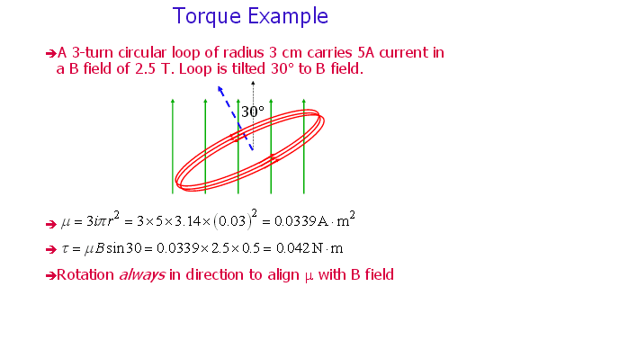

Others use the Lorenz force on a rectangular conducting current loop to demonstrate that there is no net force on a conducting current loop from its end turns, only the outer ends of the loop, but fail to realize that force isn't torque. Torque requires a moment arm which in the case of brushless motors is equivalent to the end turn length. Since torque is proportional to the winding area which is equal to
Area = slot length X slot width = slot length X end turn length
this demonstrates that end turns are a factor in creating torque.
From many sites, torque on a conducting loop in a constant magnetic field
https://www.boundless.com/physics/textbooks/boundless-physics-textbook/magnetism-21/magnetic-fields-magnetic-forces-and-conductors-159/torque-on-a-current-loop-rectangular-and-general-561-6351/
Torque = NIAB where N is the number of turns, I is the current, A is the Area, B is the magnetic flux.
Since Area equals Stator Tooth Length X End Turn Length
Torque = N X I X Stator Tooth Length X End Turn Length X B
which clearly demonstrates that Torque is also dependent on the end turns and could contribute as much as the slot turns.

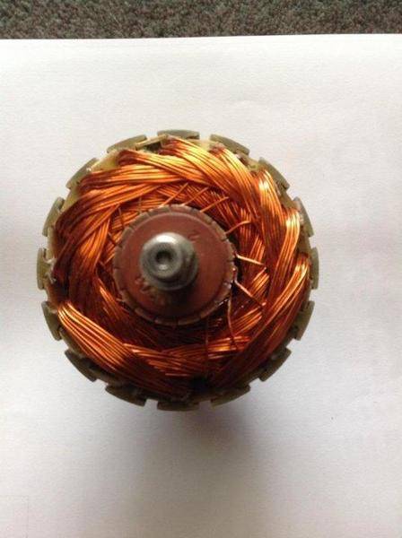

Thanks for your response. The end turns are the portion of the windings that go around the end of the stator tooth. To my surprise, from an analysis of a rectangular loop using Lorentz force analysis there is apparently no contribution to torque from the wires at the end, only the wires in the slots.
In many larger motors, the end turns are outside the magnetic flux of the stator core material and I understand that they would make no contribution to torque. I have included a photo.
I am having a hard time accepting that the same exists for these little BLDC motors because of their physical construction.

I think I have it figured out. Many use the Lorentz force to analyze the torque effects on a rectangular current loop. This reveals that it is only the slot windings that generate a force and not the ends.
Force is not torque, however. Torque requires a moment arm and in this case the moment arm is equal to the end turn length. At some level it would appear that semantics are at play in determining whether the end turns are involved or not.
The formula for torque Torque = NIAB includes the area of the loop.
Torque = N x I x slot length x end turn length X B
