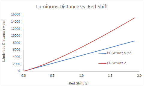

In the graph below, the blue line represents FLRW without Λ, which was our 'expected' value before 1998. After the discovery that SNe Ia did not follow this relation, we added "Einstein's Greatest Blunder" back into the metric and got the red line. While you are technically right, practically the exponent on this curve is 1.1, making it a (near) linear relation with red shift.
Yes, luminosity distance vs. redshift gives a near linear relation without Lambda, but the same is not true for the expansion curve of scale factor vs. time. The latter is the context for decelerated or accelerated expansion, contrary to what you stated before.

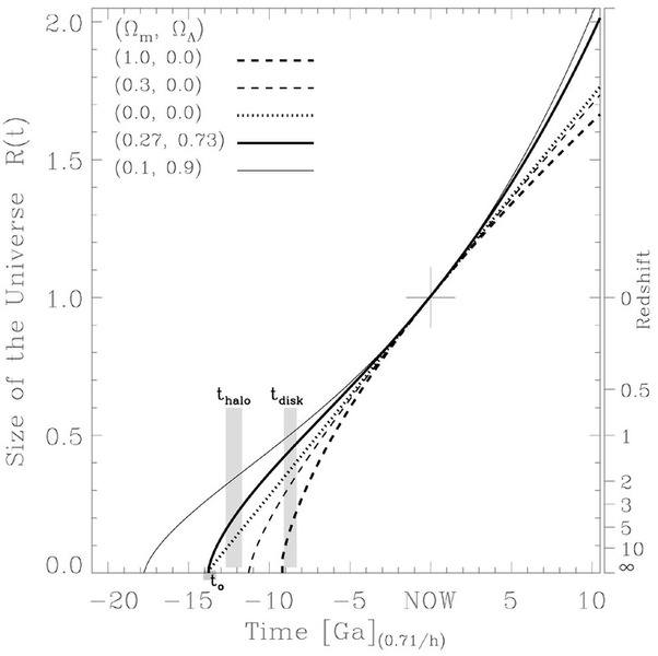

Just to emphasize what you say very clearly here:
We could get a curve for scale factor as a function of time, to show the deceleration you get from GR (our "law of gravity") e.g. with Λ = 0, so that the spatially flat case is with Ωm = 1. Observation supports near spatial flatness, so that is the case to look at---the dark dashed curve labeled (1,0) here:
AFAICS what the other poster pointed out, about near LINEAR relation between present-day observation of luminosity distance versus redshift is MEANINGLESS here. It does not give us the expansion history. If we look at the expansion history as predicted by GR (via the simplified version FRW) we can see the deceleration clearly enough.
The figure is from Lineweaver's 2003 article "Inflation and the CMB"
We could also get plots of scale factor history a(t) under different assumptions about Lambda by using Lightcone calculator since that embodies the standard FRW-based model. I should try that, just for practice.
