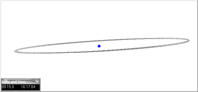

http://www.my-time-machines.net/Astro_02-16_77.jpg

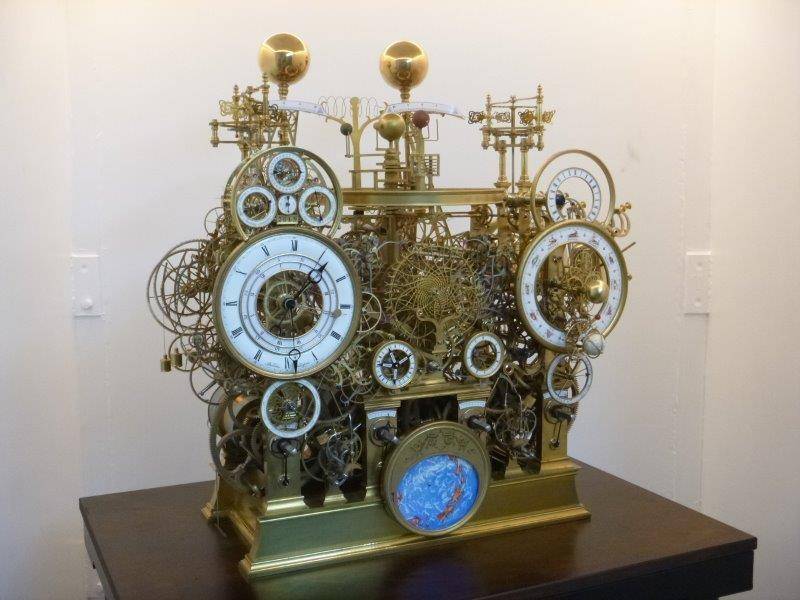

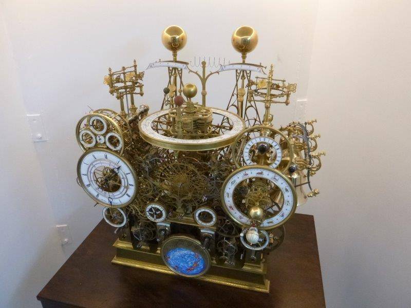

Tre Edwardian/Victorian feel was a requirement. I have the eclipses taken into account on the tellurian. As you say, there is the mechanical tollerence of the mechanism to take into account. What I am trying to achieve is a visual universe that can be viewed from various angles or perspectives. there is still a planisphere and an orrery to be attached to the clock. So one can see the universe from the Earth and then move outward and see the Earth and moon in the tellurian and then further and see the whole solar system. I am working on the moonrise/set dial so am looking for factors that affect the time of moon rise and set.
what I would really like a a set of graphs giving the magnitude and frequency of the first 4 largest factors that affect the time of moon rise and moon set.
I have to decide what to include to give me results that portray the moon on the dial in such a way that when you look our you window the moon rise will occur within a few minutes of where the clock dial says it should. This is a visual portrayal, not an observatory instrument. so we have a tolerance of say 10 minutes either way but do not want an accumulating error of more than ten minutes a year.
Tony I really like that animation. I have to translate that motion into the effect it will have on the time of moon rise and moon set in Chicago! Add into that motion the "tilt of the Earth's axis" effect .I can cope with fairly complex design concepts( I designed the rest of this clock) but the moon rise / set dial is getting the better of me.
Here are some photos of the clock.
Likes Hoophy and Andy Resnick

I don't know if this will help you, but I can make you a simulation that will output just about any number related to the Moon's position, including orbital elements and position and velocity vectors.
Here's an example: http://orbitsimulator.com/gravitySimulatorCloud/simulations/1470952670108_moonData.html
The output can be customized, perhaps as columns of numbers that you can paste into a spreadsheet so you can graph it.

Where I have bogged down is that I need to make a ball in the end of a pivoted arm rotating around a dial at approximately the same speed as the moon moves across the sky. At the 3 and 9 o'clock position we have the east and west horizon I must then make a correcting differential that speeds up or slows down the moon for each factor that affects the rise and set time of the moon. So that if the tilt of the Earth on its axis introduces a 7 percent advance and retard in rise and set time during the period of a year then I must move the differential housing forwards and backwards by 7 percent once a year. Next we have the 5 degree tilt in the moons orbit. This requires another "correction" at a different period to the first correction , So I place a second differential behind the first with another gear ratio for the moons tilt, So every factor has a period and a magnitude, I need help as to how to find this information out as, you say, in graph form. for each factor so that I can decide how many factors I need to take into account to achieve an acceptable accuracy.
