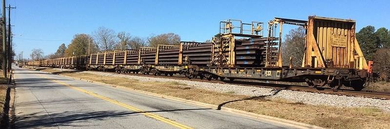

Nugatory said:
the non-rigidity of a 600 meter steel rod is going to be very apparent; it will behave more like a steel cable, all stretchy and flexible, than a rigid bar.
Like these, for example...
