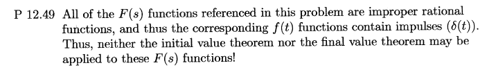

Find f(t) for the function F(s)=(10s^2+85s+95)/(s^2+6s+5) and apply the initial and final value theorems to each transform pair
Initial value theorem: f(0)=lim s->∞ s(F(s))
Final value theorem: f(∞) = lim s->0 s(F(s))
After dividing due to improper fraction:
F(s)= 10 + (25s+45)/(s^2+6s+5)
F(s)= 10+5/(s+1)+20/(s+5)
f(t)= 10δ(t)+[5e^(-t)+20e^(-5t)]u(t)
Where I'm confused is how I would apply the value theorems since there's an impulse function. When my professor did a similar problem and applied the theorems, I couldn't follow what she did, but the answer solution to this problem says the value theorems can't be applied to the function because the function is improper and the corresponding f(t) function contains an impulse.
How was my professor able to do it if it supposedly can't be done? Can someone please clarify this for me?

You forgot the 10s part!
Are you sure the limit applies to the 10 as well? When my professor did this type of problem she only applied the limit to the fractional part. I'm so confused because my professor, the solutions manual, and you are all saying different things so I have no idea what is correct.

Its simple.The theorem urges us to find [itex] \lim_{s \rightarrow \infty} sF(s) [/itex] and whether you like it or not,10s is part of sF(s)!

Well I won't have time for that, my final is in 10 hours lol. This is what the solution manual says:
Well,I think that's right.Because I was right about the limit of dirac delta being zero as the argument goes to zero.www.Wolframalpha.com confirms that! and because sF(s) becomes infinite as s goes to infinity,you can't apply the theorem.
