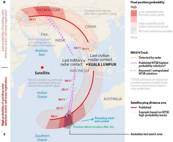

You might be right about the North/South wobble. This map showing the last 4 ping arcs of MH370 shows the satellite is not exactly on the equator. Therefore the satellite cannot remain above the exact same spot on the ground over 7 hours and therefore the position of the satellite shown on the map is not accurate but just an average position. Given that additional information (exact varying latitude of the satellite at each ping) combined with the Doppler shift for each ping, I guess it is possible to narrow the aircraft location to the South corridor.
I saw a map in some newspaper which showed a circle of possible positions around what was presumably the centre of the satellite footprint. I can only assume that would refer to the locus of locations with a given signal level (based on the satellite radiation pattern). But that would imply they could tell what the level was at the centre of the footprint. I guess there may be something clever they could do to correlate signal levels at various points on its path history, which assume a straight line (rhumb line or great circle (?) ) course. It would all be pretty speculative I think.
The North / South issue could be resolved if there were significant wobble in the orbit. But one thing bothers me and that is the beam pattern is pretty flat in the service area (sinc function) so what sort of accuracy are they dealing with?

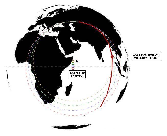

I think I have figured it now. The diagram below shows the principle of how the North/South motion of the satellite allows the North/South corridors to be differentiated.
The diagram is not to exact scale but exaggerated to show the principle. The satellite is here assumed to be moving North over the time period. Successive pings are shown as dashed circles from red -> green -> blue -> brown. Starting from the last known military radar detection, segments of constant length are drawn going North and South that assume constant flight speed. Successive pings from the North going route have progressively less Doppler shift as they get progressively more parallel to the the ping arcs. By contrast, successive pings from the South going route have progressively more Doppler shift. This is presumably what the Inmarsat team detected.
Additionally, the South going route follows a great circle which is what you would expect from an aircraft on auto pilot going on a fixed heading. The North going route on the other hand is clearly not on a geodesic and requires continuously varying change of direction from a pilot with detailed knowledge of what would be detected by detailed analysis of the Inmarsat data.
It seems the possibly unintended 'imperfection' of the satellite's geostationary position is what made location of the aircraft possible with a single satellite. If that is the case it would seem to be good idea to increase the North/South wobble of the satellites or add some non-geostationary satellites to the Inmarsat satellite constellation. That way, satellites could track aircraft across oceans (or anywhere else) in near real time, using the current technology already installed in most commercial aircraft. The additional safety and chance of being rescued in a timely manner would surely be worth the cost. In fact, it is a bit shocking to me, that most aircraft on oceanic routes or on overland routes far from airports are "off radar" most of the time. See http://planefinder.net/
NOTE: The ping arcs are shown as perfect circles in the above diagram, which is an approximation. This is only valid for a satellite position exactly in the centre of the map. For perfect accuracy, the ping circles should become increasingly elliptical as the satellite position deviates from the centre of the map. (Some of the maps published by the press do not take this into account.)

Most of the Doppler effect is due to the movement of the aircraft (in flight) which is much greater than the movement of the satellite relative to the ground, but nevertheless, you were right that the key ingredient to differentiating the North route from the South route is the movement of the satellite itself.

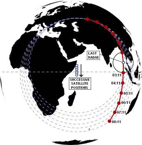

I have just noticed that the diagram I posted in #12 has the arrow indicating the satellite motion pointing the wrong way. Here is the corrected diagram with some minor refinements:

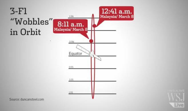

In post #17 I assumed the satellite was going South as the was the best fit to the information I had available. This diagram captured from http://live.wsj.com/video/flight-370-how-pings-revealed-the-flight-path/991D6CB0-852F-4D44-9B44-6107093815EC.html#!991D6CB0-852F-4D44-9B44-6107093815EC confirms that was in fact the case.
The diagram shows the satellite started heading South back towards the Equator at around 03:30 AM not long after Malaysian Airways flight MH370 also started heading South into the Indian Ocean. The data for the diagram comes from a much more detailed account given by http://www.duncansteel.com/
03:30 hrs (19:30 Hrs UTC) is also when the chart in post #15 for the Doppler shift of MH370 changed from decreasing to increasing.

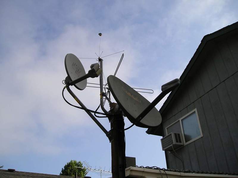

I monitor KU band satellite broadcasts over NA on a 1M movable dish as a hobby using several DVB PC cards in a Linux server, most are pretty stable in orbit but a few are getting long in the tooth and have the 'shakes'.
