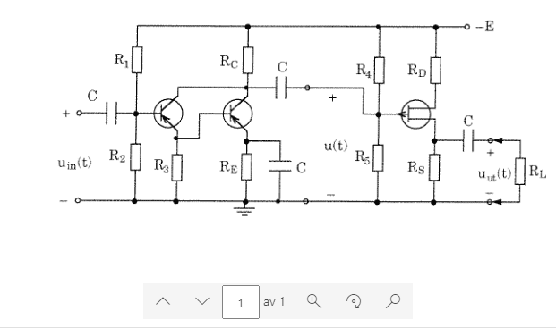

Determine the outimpedance of the first amplifier stage and the inimpedance of the second amplifier stage.

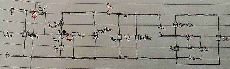

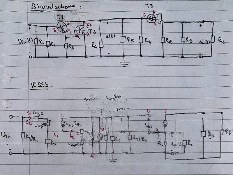

Hi, I have a circuit with 3 transistors I want to rewrite to a small signal model. When multiple transistors are in the circuit I get confused how to do it. This is the signal model and small signal model I have. Is it wrong?

Hi, I have a question regarding a transistorscircuit. I have drawn the small signal model of the circuit in the first picture, with capacitors replaced with short-circuit and grounded "-E". Furthermore, this simplified small signal model, with 1/g0, h22, h12 neglected. So, for this circuit is the outimpedance of amplifier stage 1, Zout1, Rc and the inimpedance for the second amplifier stage, Zin2, R4//R5? Or does for example the second amplifier stage somehow affect Zout1?
In this case, I think it's better to think of it as the input impedance of the 2nd stage loads the output drive of the first stage.

Oh, so Zin2=Rload for amplifier 1? Because in my notes I have that Rload does not affect the outputimpedance. When you decide Zout you remove Rload. This is how my examiner said. Have I understood it wrong or?
The input impedance of the second amplifier loads the output impedance of the first amplifier, but that effect does not change Zout1. What it does affect is the impedance at the node which is the connection of the collector of the bipolar transistor and the gate of the FET. If you're still having trouble understanding something, please explain in detail.
Thanks for clarifying. I only have one more question. This is atleast how I have understood it, correct me if I am wrong.
When I calculated U between amplifier 1 and 2 I had the input impedance from amplifier 2 in my calculations. The inimpedance of the FET is infinity (given in the assignment), therefore no current from amplifier 1 flows through the FET transistor. If I call the current through U Ic, then U=-Ic*(Rc//R4//R5) and Ic is the collector current from both BJT-transistors.
Furthermore, U is also (by using KVL): U=Ugs+gmUgs(R3//RL).
I believe you are in Sweden, so U is a voltage; is this so? If U is the voltage at the node which is connected to the collector of the BJT and the gate of the FET, then what current are you referring to when you say "the current through U"? It would be helpful if you posted a schematic with the nodes labeled and currents shown as arrows where they flow.
So, I don't see a question in your last post. What is your question?
Yes, U is a voltage. I was referring to the scheamtic above, but I can show an updated one, I should have been more clear (in red the currents are IB1, IB2, IC). Furthermore, I can show you what current I have calculated so you know what I mean. My question was if my reasoning in the message prior was correct.

Your two expressions for U in post #8 are correct.
Oh okay, then I know I have thought a bit correct. Thanks for the help, I really appreciate it.
