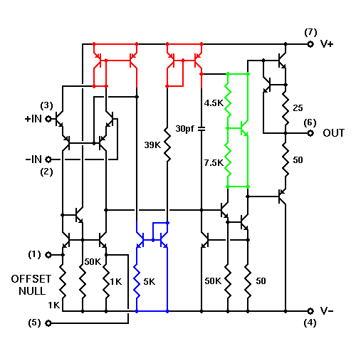

There are two approaches, or levels, at which people "understand" op-amps.
The first level means to accept, pretty much on faith, all the idealized assumptions such as (1) the input current is zero, and (2) the output gain is infinity, and use those assumptions to figure out how the external resistors, capacitors, etc. will affect the output.
The second level is to understand the internal circuitry of the op-amp, which means to understand this circuit:
(from http://www.play-hookey.com/analog/inside_741.html )​
Since we are trying to find some level in between those two, we'll have to give up the notion that the input current is exactly zero, since that is leading to wrong conclusions.
