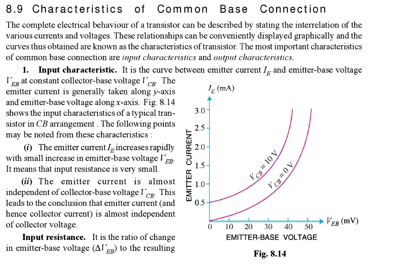

Does this mean that the forward bias p-n junction starts behaving as a conductor at very small input voltage i.e. of the order of 50 mV and it decreases as VCB increases?
The two circuits i.e. forward bias circuit and reverse bias circuit are independent. Then why should ##I_E ## depend upon ## V_{CB}##?
Yes.
The opposite. Since emitter current increases with Vcb for a given emitter-base voltage, raising Vcb makes the e-b junction look more like a conductor, not less.
What two circuits? It's the same circuit.

I wanted to know, why does ## I_E ## depend on ##V_{CB}##?
Good question. Google the Early Effect in bipolar junction transistors. Wikipedia has a very good explanation.
