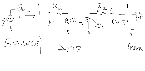

As mentioned, input impedance happens where you decide the input is and output impedance happens where you decide the output is. It's just a name but maybe it's easier to understand in terms of an amplifier.
Real amplifiers are not ideal elements. They load the input source and cannot deliver output that is not affected by whatever is attached to it. If we model the amplifier as a box, it has a two-wire input port and a two-wire output port. At the input we call the Thevenin resistance of the amplifier the input impedance. It affects whatever we use to drive the amplifier at the amplifier input. It's the impedance seen looking into the input of the amplifier. At the output, we may attach speakers. The amplifier behaves like a voltage source in series with a thevenin impedance at the output. That impedance is called the output impedance because it is at the output of the amplifier. You see, it's all about what direction signals are travelling.
A diagram is attached below.
Some uses from that diagram:
The input source could be a microphone. Microphones are very weak signal generators -- they act like small voltage sources connected to large output resistances. So Vs is tiny and Rs is large (note I am using a thevenin model for the microphone; Rs is called the output impedance of the microphone because it appears at the microphone output). If the input impedance of the amplifier Rin is small, the amplifier sees an even tinier signal because Rin/(Rin+Rs) is small. This signal would be swamped by noise. So you can see the thevenin resistances at the input summarize how well the microphone can drive signals and how badly the amp loads an attached driver.
At the output, speakers are attached. This is where a lot of power is consumed to turn electrical energy into acoustical energy. You want to do this efficiently. With a little calculus, you can determine that energy is transferred to the speaker at maximum efficiency if the output impedance of the amplifier is equal to the input impedance of the speaker. So you may want to add circuit elements to adjust the output impedance of the amplifier to get that max efficiency.
In the real world, devices don't behave as resistors -- their behaviour is frequency dependent and this means an accurate model must include capacitors and inductors. Some of these will be added deliberately to get desired behaviour but most will be parasitic, making our perfect circuits do bad things. At the output of the amplifer for example, the speaker may have poor frequency response at the low end. We model the speaker as a high pass filter and its thevenin impedance will be complex (as in s-domain). We can perhaps compensate for that in the amplifier by emphasizing bass (the equalizer) but how much? Well all that is summarized in the speaker's input impedance.
Here's another one. Your circuit analysis assumes currents and voltages appear instantly at all points in the circuit when they change. That, of course, doesn't happen in real life because EM fields are limited by the speed of light. It turns out if the frequencies your circuit operates at have a wavelength approaching the dimensions of the circuit, the lumped parameter model (what you assume when voltages appear instantly) no longer applies. You then have to analyze the circuit taking the speed of light into account. This effect can especially be seen in long wires, for example transmission lines, ethernet cables, usb cables, etc. It takes time for the signal to propagate from point A to point B. It turns out that if the impedance seen by the wave at the end of the cable does not match impedance of the cable where the wave is coming from, reflections occur. So this means you have to make the impedance looking into your receiver circuit match the impedance of the source cable.
Another one. In designing analog filters, we are normally doing so from a desired transfer function. If the transfer function is written in a certain form, we can implement it is a ladder network (series L, parallel C, series L, parallel C, etc). We decompose that transfer function by extracting the series L (T(s) = sL + T'(s)). We can then see the remaining impedance looking into the rest of the circuit is a capacitor in parallel with soemthing else, etc.
