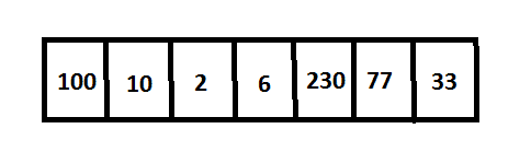

Hi! (Smile)
$\text{ Could you explain me how I could sort the following list, applying the Insertion sort ? }$

This algorithm uses an array, instead of a list. How could we apply the Insertion Sort to a list? (Thinking)
A list is an abstract data structure which holds an ordered sequence of elements. An array is one concrete way to implement a list, by storing the elements contiguously in memory and simply interpreting A as "the ith element". Basically, an array is a kind of list. Does that answer your question?

I understand the Insertion Sort.. But, could you explain me how I can apply it to lists? (Thinking)
What is your definition of a list? What do you think a list is? How would you access the elements of a list in pseudocode? (that's actually the only operation needed in insertion sort since you don't need to add or remove elements, only compare and swap)

At the following algorithm:
Code:
1.Insertion Sort(A[1...n]){
2.  int key,i,j;
3.  for (j=2; j<n+1; j++){
4.       key=A[j];
5.      i=j-1;
6.       while (i>0 && A[i]>key){
7.                A[i+1]=A[i];
8.                i=i-1;
9.       }
10.      A[i+1]=key;
11. }
12.  return A;
13.}
I changed the lines 7,8 like that:
Code:
 Nth(A,i-1).next=Nth(A,i+1) , Nth(A,i+1).next=Nth(A,i)
Is it right? (Thinking)

What could I change after the $7^{th}$ line? (Worried)
Manipulating the list halfway destroys normal access to it. (Worried)
You can resolve this by tracking the relevant pointers separately.
For instance:
Code:
7.                P = Nth(A, i+1)
8.                Q = Nth(A, j-1)
9.                R = Nth(A, j)
10.               P.next = ...
Btw, should you be referring to j and j-1 here? (Wondering)
For instance:
Code:
7.                P = Nth(A, i+1)
8.                Q = Nth(A, j-1)
9.                R = Nth(A, j)
10.               P.next = ...
So, should it be like that? (Thinking)
Code:
    1.Insertion Sort (NODE *A){
    2.   int key, i, j=2;
    3.   while (A.next != NULL){
    4.        key=Nth(A,j).data;
    5.        i=j-1;
    6.        while(i>0 && Nth(A,i).data>key){
    7.                P=Nth(A, i+1);
    8.                Q=Nth(A, j-1);
    9.                R=Nth(A, j);
    10.               Q.next=R.next;
    11.               R.next=P.next;
    12.               P.next=R;
    13.               i=i-1;
    14.       }
    15.       P.data=key;
    16.       A.next=A.next.next;
    17.       j++;
    18.  }
    19.  return A;
    20.}
Code:
    7.                P=Nth(A, i+1);
    8.                Q=Nth(A, j-1);
    9.                R=Nth(A, j);
    10.               Q.next=R.next;
    11.               R.next=P.next;
    12.               P.next=R;
That would work better, but you're swapping the wrong values.
You're supposed to achieve [m]A[i+1]=A[/m]. (Worried)
Anyway, it would be better to leave the elements where they are, and just reassign the values.
You can do that with: [m]Nth(A,i+1).data = Nth(A,i).data[/m] instead of what you have now. (Wasntme)
The prof told us that we should not just reassign the values. (Shake)
Could you explain me what I could change, in order to achieve $A[i+1]=A$? (Thinking)
Since you won't to lose track of any of the nodes, you'll have to swap those 2 around (as in the movie ZaidAlyafey posted (Wink)).
Code:
P = Nth(A, i-1)
Q = Nth(A, i)
R = Nth(A, i+1)
P.next = R
Q.next = R.next
R.next = Q
But what would be much better, is if you use the inner while-loop only to find the place where the key should be inserted.
And, after the while-loop, move the node with the key to that location. (Mmm)
Code:
P = Nth(A, i-1)
Q = Nth(A, i)
R = Nth(A, i+1)
P.next = R
Q.next = R.next
R.next = Q
So, do I have to do it like that? (Thinking)
Code:
       int key, i, j=2;
            key=Nth(A,j).data;
            i=j-1;
                 P = Nth(A, i-1);
                 Q = Nth(A, i);
                 R = Nth(A, i+1);
                 i=i-1;
             P.next = R;
             Q.next = R.next;
             R.next = Q;
             P.data=key;
             A.next=A.next.next;
             j++;
       return A;

What happens if you apply this algorithm to the list in your OP? (Wondering)
  • #32
I like Serena said:
Something like that... (Sweating)
At the first iteration, in the inner while loop isn't it P=Nth(A, 0); ? (Thinking)
Which is its value? (Thinking)
  • #33
