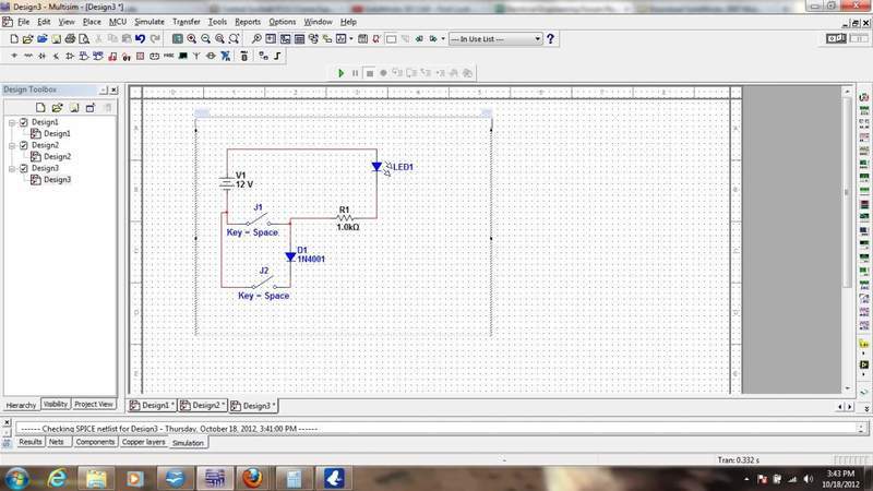

I’m trying to install some LEDs in my footwells.
I have a pink wire, which is my positive, and a gray wire, which is my negavtive. This is a negative switched circuit.
So, is it ok to hook it up like this?
1 Positive of LEDs to pink, negative to gray.
2 Then, use a diode on the gray wire, with the stripped end pointing away from the leds back to the gray. Now, on the non stripped side of the diode, add a wire which connects to a switch. Then, connect the other side of the switch to the ground on my cigarette lighter?
The first part works I know. But can I just use a diode? Or do I need a relay? I know the second step functions I just want to know is it safe?
Also, if the second isn’t safe, would it be safe to ground it to the car instead of into the cigarette lighter?
Thanks!
Oh- finally, if that does work, does the ground of the cigarrette lighter function as a ground 24-7? Or only when the car is on?

Wouldn't you just want the LED strip to come on at the same time as the dome light? That is when you open the door or if someone turns the light on with the switch?
If so, then you need to connect the LEDs directly across the dome light.
The circuit for the dome light is just 12 volts positive, through a fuse, through the dome light and then through a door switch to ground. This switch has another on-off switch in parallel with it so that you can use the light for map reading etc.
My car also has a timed switch so the light stays on for a minute or so after you leave the car, presumably so you can find your way to the front door of your house.
I do want it to function like that, but I do also want it to be able to be on while I'm driving. They are very dim so they're not at all a distraction, so I would like to be able to do that.
So knowing that, how does all that look?
All that would be possible. You just have a PNP transistor that turns on when the door switch closes. You do that by connecting the base resistor of the transistor to the non-grounded side of the switch, via a diode.
When the door opens, the switch closes so base current flows and the transistor turns on, turning on the LEDs.
Then, you have another switch and another diode and base resistor which you can operate when you want the LEDs on when the door is closed.
HOWEVER, unless you have some experience with this sort of circuit, you would be better off just getting a cigarette lighter plug and putting a switch in series with the LEDs so you can turn them on whenever you want to.
why not like this?
