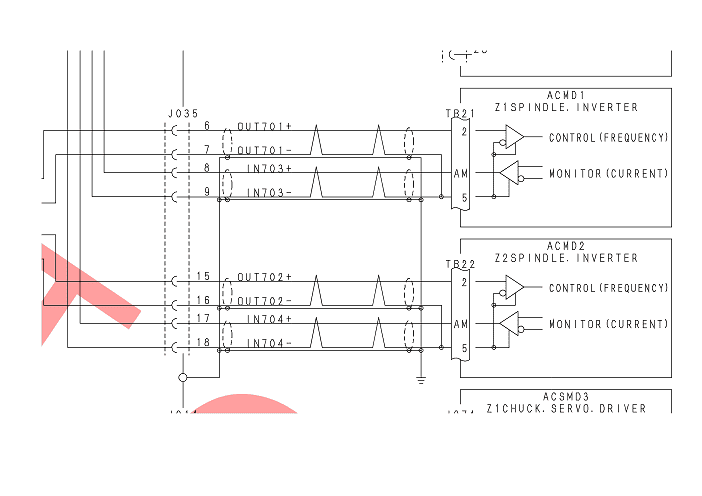

I would like some assistance to select the right sensor/transducer to monitor current from an inverter to the spindle motor it feeds. If it is possible to get RPM signals from the inverter please advice on how to go about it. Please suggest the most suitable sensor/s to achieve both current and RPM (if possible), if not, just current.
Inverter: Mitsubishi Transistorized Inverter (FR-A500-3.7K)
Inverter output voltage: 200 to 240 VAC 3-phase (u,v,w terminals pg 12) 50/60 Hz
Attached is some technical info for the inverter. Pages 220, 12, 41, 2 & 36 may be of considerable interest. Page numbers mentioned here are the page numbers printed at the bottom of each page in the attached technical manual for the inverter. Thank you for taking the time to help.

Page B33 of the 841 Technical Reference shows analogue speed control voltage and current monitor signals on the inverters connecting to the ANLG1 module. See attached image of part of that page.
When you pick off the the voltages at one end of the screened twisted pair cables you will be able to digitise and record those parameters with an external recorder.

Crankshaft1983 said:
So I was wondering if there is a way to pick those analog or digital signals from the inverter or the machine (machine technical manual attached) then route it through a DAQ to a computer for analysis.
Re: My post #17 attachment. Have you looked at page B33 of the 841 Technical Reference ?
I believe that should now have solved your problem.
Likes 1 person

Yes Sir, thanks much for all the help. Hopefully I can successfully get the data routed to my computer.
Well this is the main reason I'm hassling with this machine. Spindle current for the Z1 axis goes into
over-current mode when it reaches 12.1 amps or more causing it to burn wafers occasionally. The pre-set parameter value is set to 12. I don't know why this is happening but I figured monitoring the current while in operation over time might help shed some light. Any ideas why this is happening? or suggestions on what to check for or look into? Thank you
