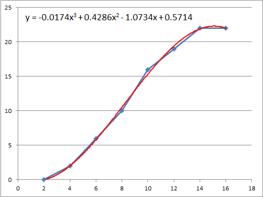

Hi folks,
This is pretty pedantic, but I liked this exercise, so there. Some remarks:
The story is about an accelerating car, so gear shifts can be a reason for a not-all-that-smooth acceleration versus time.
That aside, the exercise tekst wants a smooth curve drawn. I'm no artist, so I let a program (Excel ?:) ) do the work: a third order polynomial does a reasonable job. Again, it doesn't know the driver takes his foot off the pedal at 14 s, so it overshoots, but never mind. And the four-digits are way too much accuracy (And yes, I did find the button to reduce that, but too late). See the red line.
I am pleased to see it indeed draws the line through (10, 15) -- but, again, it doesn't know about possible gear shifts.
Slope of line = derivative = instantaneous acceleration at t = 9, 13, 15s: 2.4, 1.25 and 0.04, respectively.
In view of the accuracy of the data, 2.5, 1.5 and 0 are adequate.
3.5 or 3 m/s2 at t = 9s to me seems on the high side. Unless it's a pretty bad driver, fumbling that gear shift -- but in that case a smooth line isn't justified.
