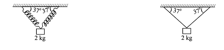

The blocks are of mass 2 kg shown is in equilibrium. At t = 0 right spring in fig (i) and right string in
fig (ii) breaks. Find the ratio of instantaneous acceleration of blocks?
In fig (i) before the string is cut,(2kx)sin37° = 2g , kx=g/sin37°
In fig (ii) before the string is cut,(2T)sin37° = 2g , T=g/sin37°
Is the instantaneous acceleration in the two cases same i.e ratio 1:1I would be grateful if somebody could help me with the problem .

I know physics isn't democracy, but I'm inclined to vote for 1:1 too!
Net force after cutting will be minus the missing force, and these are equal.
I'll be listening into see if someone can prove me (us) wrong!
What is the state of the spring at t=0? Stretched? Equilibrium? Compressed?

I don't think so. When the string is cut, the acceleration of the mass is purely tangential. When the spring is cut, the acceleration is not purely tangential.
Chet
Excellent thinking!
Are you getting 25/24 ?
Tanya Sharma said:
Excellent thinking!
I haven't actually worked the problem. Let me try it for real and see what I get.
Chet
Tanya Sharma said:
Excellent thinking!
Yes. I confirm that result.

In the first case i.e having springs
From equilibrium condition kx = 5g/3
After string is cut , the acceleration of the block will have both radial and tangential components .
at = 2gcos37° = 8g/5
ar = kx - 2gsin37° = 5g/3 - 6g/5 = 7g/15
∴ net acceleration a1 = 5g/3
In the second case i.e having strings
From equilibrium condition T = 5g/3
After string is cut , the acceleration of the block will be purely tangential i.e ar = 0
∴ net acceleration a2 = 8g/5 So a1/a2 = 25/24

An old thread, but more interesting than it looks.
We forever encounter questions involving unrealistic entities such as inelastic or inextensible strings, perfectly elastic collisions, etc. These are defensible if the result matches the limit as that ideal is approached; but it doesn’t in this question.
If we allow the string just a bit of extensibility (finite k) then the force exerted by the remaining string cannot instantly drop. The immediate acceleration of the mass is exactly the same in both cases. Taking the limit as the string's k value tends to infinity does not alter this.
