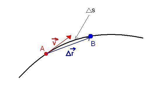

The displacement is a vector, the distance traveled is scalar. They are not the same.
The average speed vav is Δs, the distance traveled by time Δt, divided by Δt. You get the instantaneous speed v if you take the limit when ##Δt \rightarrow 0## :
[tex] v = \lim_{Δt \rightarrow 0} \frac{Δs}{Δt}[/tex]
The speed is scalar.
The average velocity is the displacement from A to B divided by Δt. It is a vector. The instantaneous velocity is the limit
[tex]\vec v = \lim_{Δt \rightarrow 0} \frac{\vec {Δr }}{Δt}[/tex]
In the figure, the distance traveled between points A and B is equal to the length of arc AB. If the time Δt is very short the length of the displacement vector from A to B tends to the length of the arc AB. So the magnitude of the instantaneous velocity is equal to the instantaneous speed. And the velocity vector is parallel to the tangent of the curve at point A.

So the final answer is that if we consider really small intervals of time, the magnitude of displacement is equal to the distance traveled (or the displacement vector tends to the arc AB as pointed out by ehild) and hence the magnitude of velocity will be equal to the speed at that instant. Is this right?
It is right.
