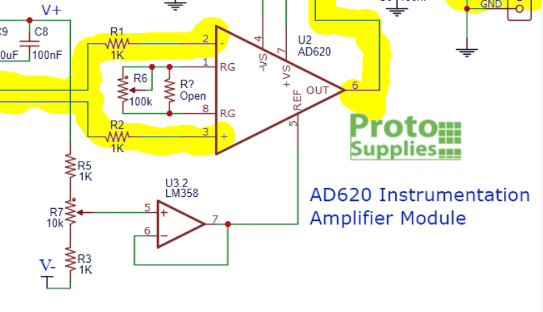

i want to buy module
i came across this now also
https://protosupplies.com/product/ad620-instrumentation-amplifier-module/
please can you tell is this also good , too much pins confused me
does this model also do not need an external instrumentation amplifier>

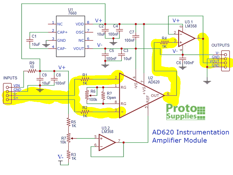

If you cannot recognize the symbol of the inst. amp (IA) in your link schematic, I suggest you do more reading about common mode noise rejection and read how to use it with biasing and sensor cables, DC voltages.
Then how you must be concerned with imbalance in both wires and possibly shield them with STP wire to reduce unbalanced injection of grid E-fields.More importantly, you must learn to define your expectations or specs on overall project plans. Analog? Digital? Packaging? Power Supply or battery? and all the specs for gain, SNR and output format. Single supply or bipolar?

Quick Quiz Question for those reading this thread... What is the technical error in the circuit for U3.2, and how will that error manifest itself? :wink:
The root of all evil, is connected to pin 5, REF.
Worst PSRR design ever.
One nearly universal rule in precision analog design is that you don't use the PS voltage as part of the signal path.
Also, most of my EE career was spent getting rid of trim pots in real circuits. Real circuits are the ones that are built by other people and sold for money, over and over again. When I started in DoD work, they were essentially forbidden. Later in the high performance commercial world I inherited products full of them. It was a manufacturing and field service nightmare. Everyone thinks they can make a circuit better by adjusting it, in fact it is probably only the original designer, that knows why that pot is there. We'd get boards back where the only problem was that someone tried to fix it with a screwdriver. Plus, they are crappy resistors, both electrically and especially mechanically. It is the mark of either a one-off demonstration design (like something you might sell to a hobbyist), or a crappy EE.
As an aside, that company used IC sockets in earlier designs. When my generation took over in the late 1980's we determined that the IC sockets were a big reliability problem and eliminated them. You would not believe the grief we got from our field service people who said "we need those sockets, we change ICs all the time to fix things." Our response was, yes, we know, that's exactly the problem we are fixing. It worked great.

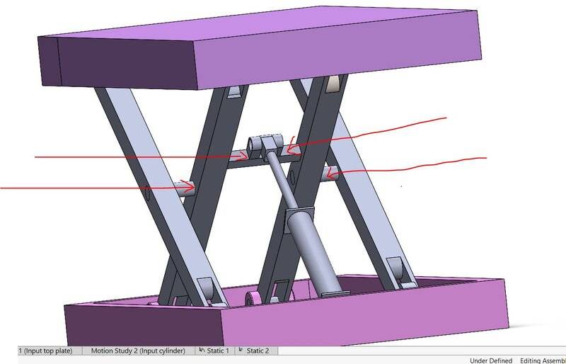

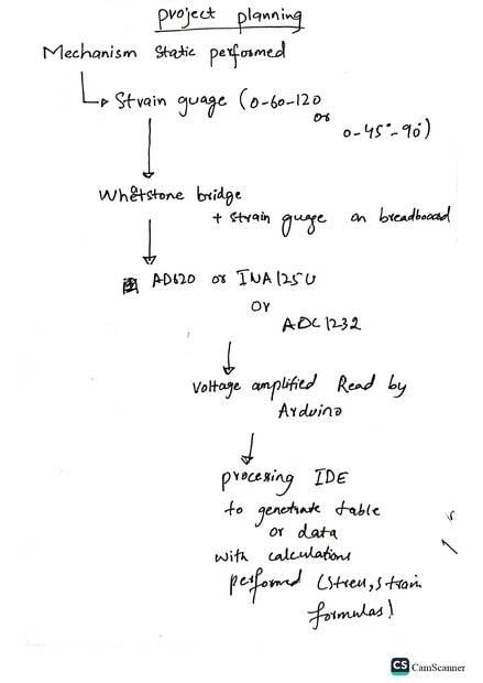

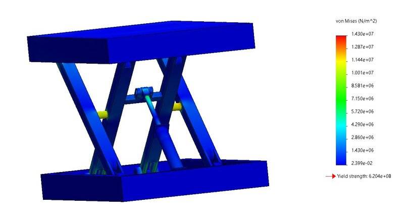

the following image is mechanism static study and project planning .waiting to your kind reply

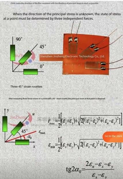

the strain gauges selected for this project will assist to determine stress, strain all three direction
0-60-120 or 0-45-90 with 120 ohm
Arduino will reading data from a Wheatstone bridge circuit and sending the data to a computer via serial communication. The data sent to the computer includes the voltage values calculated from the analog readings of the Wheatstone bridge circuit.
One big question
Rosette strain guages consist of three guages so should i connect all guages in wheatstone bridge and give one input to Arduino or separate make wheatstone bridge for every guages and connect to three IA , so in this ways 3(wheastone bridge) + 3( IA or ADC) ,please which one is best practice and most efficient way
One more question
To study experimental stress in the given model should we use IA or ADC

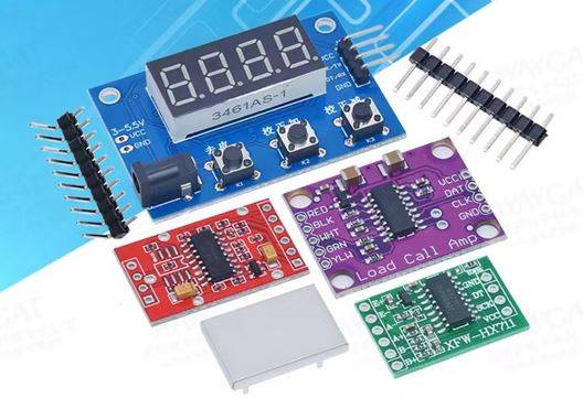

You need both an IA and an ADC.
Use the Spark Fun Load Cell Amplifier - HX711.
Look at the HX711 datasheet, that shows it is both an IA, and a 24 bit delta-sigma ADC, all in the one package. It is designed to interface directly to a resistive bridge strain gauge.
https://cdn.sparkfun.com/datasheets/Sensors/ForceFlex/hx711_english.pdf

thank you for reply so rosette gauges consist of three so i need three hx711 amplifier.i study in google that hx711 used for weight measuring applications . does this amplifier will be applied for my mechanism
please also tell which one will be more preferable or should i buy just chip not module

Micheal_Leo said:
One big question
A bridge is most sensitive to strain and least sensitive to temperature changes. The way you connect the gauges will depend on what you are trying to measure. You can rotate gauges 90°, or place them on opposite sides of a sheet or structural member. Maybe post a link to the gauges you will use.
The HX711 selects between two pairs of connected inputs; (A+ & A-) or (B+ & B-). So one HX711 module can handle two bridges, one at the time.
You do not have time, nor need, to fabricate the circuit boards.
Buy two of the assembled modules, then experiment with the Arduino code, the strain gauge geometry, and the connections to the gauges.
Likes Micheal_Leo

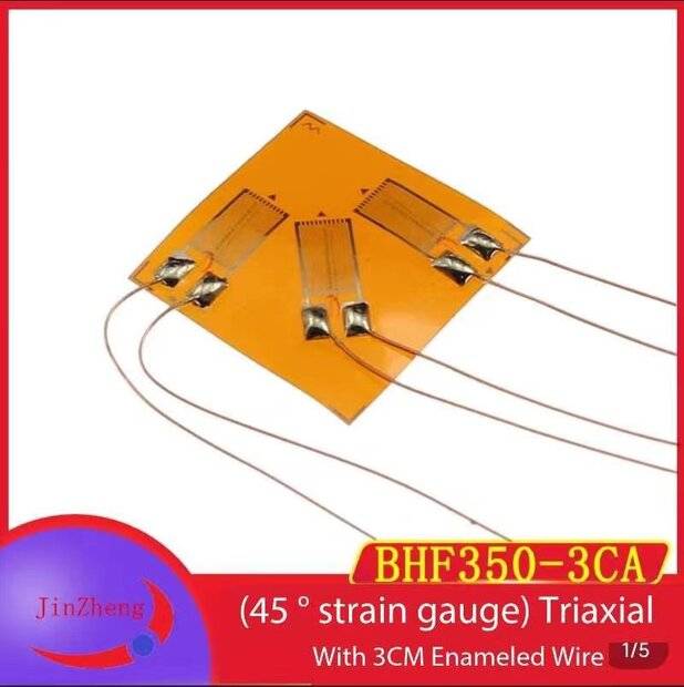

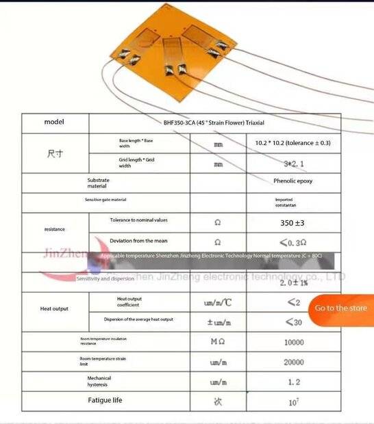

my first choice will be 0-60-120 configuration i am not sure i can find in china
but second choice will be this BHF 350-3CA ( strains at specific point )
but second choice will be this BHF 350-3CA ( strains at specific point ) or BHF 120-3CA
Micheal_Leo said:
just an example can i make rosette strain gauge by chossing three identical strain guages and attached at angles measured precisely on component
Yes.
If you know your principal axis, why do you need a rosette?
A bridge is a better solution, because it is balanced, and independent of temperature.
Likes Micheal_Leo
No current being drawn through the wiper. That point of contact eventually becomes intermittent. At least that's one of them.
  • Love
Likes Micheal_Leo and berkeman
Perfect, yes, that's what jumped out at me as well. Pretty amateurish mistake for a schematic that got published on the web, IMO. The opamp input bias current looks to be several orders of magnitude below the minimum wiper current for reliable potentiometer operation.
That circuit will work fine on the workbench and in initial testing, but will fail in the field after a while. Operational reliability testing at 85C/85%RH for 1000 hours (Accelerated Life Testing) of the product prior to First Customer Shipment would hopefully catch this error.
Likes Micheal_Leo
Shout out to EEPOTs. They stay where you put them. A yahoo with a tiny screwdriver can't change them, but your SW calibration routine can (even for the end user, like in your network analyzer). Any calibration adjustment MUST have a well documented, and ideally controlled, procedure.
Still not great resistors in them, but you can't have everything.
Likes Micheal_Leo
