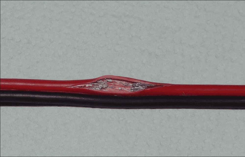

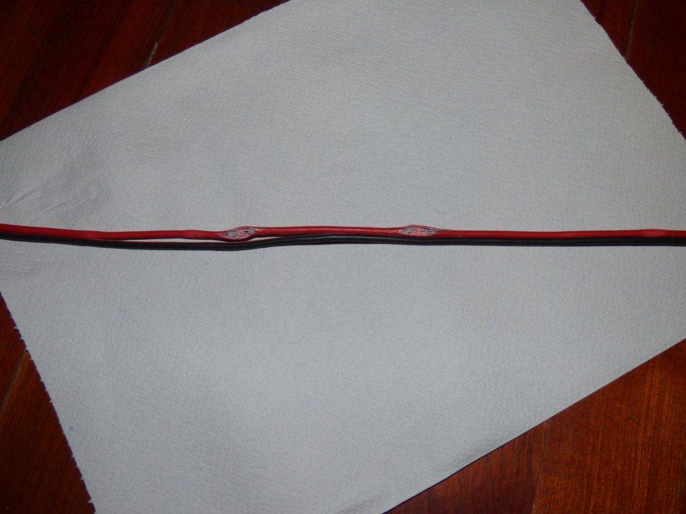

Insulated copper wires (bare copper/not plated) inexplicably turned into gray powder. Wires are intact between affected spots.
Summary: Insulated copper wires (not plated) inexplicably turned into gray powder. Wires are intact between affected spots.
This is a piece of common red/black loudspeaker cable, with PVC insulation, pulled from service after about 18 months from installation. It was used to feed a small loudspeaker in an office, to provide low-volume background music during working hours. The loudspeaker began to malfunction and eventually ceased working. After checking all the connections, the amplifier, and the loudspeaker itself, the owner remover the cable and found what is shown in the photos. The two outer segments of the cables, that were located out of the floor (they went from the floor to a junction box in the wall on one side, and from the floor to the loudspeaker on the other side), are absolutely normal. The central section of cable, which ran in a plastic flexible tubing for electrical cables under the floor (about 3.5 meters/11 feet) shows something inexplicable. The black wire is ok, only the red wire is affected. The red insulation shows, at irregular intervals, several slight "swellings". Diameter in correspondence of the "swelling" is 0.5 to 1 millimeter larger than diameter of unaffected sections, and the length of each swelling is about 8-10 millimeters. If I cut longitudinally into a swollen section, I discover that the copper wires (bare copper, not tin/silver plated) have disappeared, converted into a grey powder (the powder had been blown away before taking the photos). I haven't seen anything like that before, nor I have read or heard of anything of the same sort. I wish to understand the reason why only the red-insulated wire was affected, and not the black. I wish to understand the reason why only some short spots were "pulverized", while the copper wire between the spots is intact! The comment of the office's owner: "It was pure luck that it was just a stupid loudspeaker cable, but if it was something else? A power cable? A grounding cable? A security system cable?". But above all, my thought is: if a brand-new cable, installed in an office, could deteriorate to that condition, apparently for no reason, then ANY cable, installed anywhere (especially outdoors) might end up the same way, without knowing the reason why! I cannot accept that such a thing could happen without explanation. Remember, it was a brand-new cable when it was installed, and it took only 18 months to get to that condition. And only in the section which ran under the floor (the floor was not new, it was built several decades ago). Needless to say, the office is a full-indoor city office, no exposure to weather.
If you need further details, please ask.

I’d guess they were copper-coated aluminium, and something in the red PVC coating reacted with the aluminium. Perhaps there were some defects/pinholes in the copper coating. I’d also guess they were cheap cables.

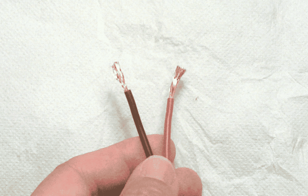

- the material of the conductors is BARE COPPER. My technical formation is in industrial electronics, I can tell the difference between aluminium, plated copper, and bare copper, please... ;-) Anyway, here is a picture of one end of the cable, with the PVC insulation stripped...
- when the cable was installed one and a half year ago, the exceeding length was cut away and stored in a drawer, in the same office. I recovered it, and I can tell that it does NOT show any anomaly (just like the two extreme portions of the installed cable that, as I explained above, didn't go under the floor but went straight up from the floor to the junction box on the wall on one side, and to the loudspeaker on the other side).
What about aluminium coated with copper? That’s what we think’s involved, and your picture doesn’t show a scrape of the wires. Very common in cheap imported electronics, Al wire with Cu coat can also be identified by it’s tendency to spring back when bent.
My lens is not good enough to magnify the cross section of the cut wires, but please trust me when I tell you that it's PURE COPPER, not copper-coated aluminium. It's my job, I think I know my trade... thank you.
Corrosion due to trapped vapour is going to be centered at the lowest-coldest points in the cable where the vapour is densest or condenses, at other points the warmer or cyclic room temperatures tend to keep vapour moving. A DC component in the cable current may aggravate electrochemical corrosion, and I believe some cheap radios do allow DC through the speaker coil.
The problem is chemical damage, and only in the red cable.
My guess is that an impurity in the red PVC insulation batch, (recycled?), was not properly mixed and was included in the cable during the extrusion process. Alternatively the wire was wet and/or contaminated prior to cladding.
Swelling indicates the copper has been converted to a higher volume Cu compound. Maybe the reaction progressed at higher temperatures while the cable was being shipped, in storage, or in the duct.
Hydrous copper chlorides can be a white to greenish or blue grey.

The manufacturing process requires each fine wire be drawn at speed through a die. I would expect any change in the metal composition to damage the wire during that process.
Individual wires are then spun to form the cable. If there were patches of different composition in the individual fine wires, it would not be possible to align them all so as to react and swell in the same place in the multi-strand cable.
I believe contamination of the spun wire bundle, or the insulation must be the prime suspect.

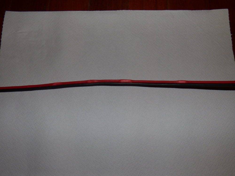

@NascentOxygen the corroded patches are uniform in size, but NOT equally spaced. You may have got that impression from the short segments depicted, but it was not possible to take a photo of the whole cable length (the "swellings" would be almost invisible)

P.S.: the corrosion spot on the black cable went unnoticed until yesterday not only because of the less prominent "swelling", but also because there is no discoloration of the black PVC, whereas the red PVC is noticeably discolored where swollen.
