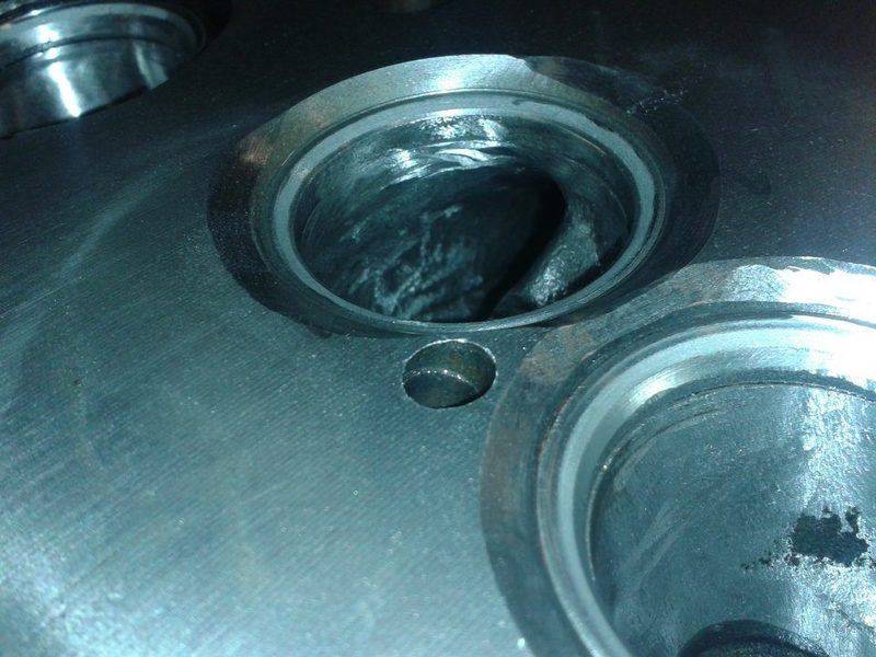

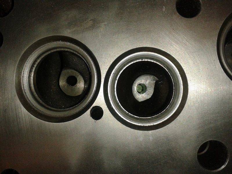

This is a Cummins diesel 12V head.. intake is on the left and has a "swirl ramp". Not the large casting boss around the exhaust valve guide, this is one of those flat walls I'm talking about that would reflect waves back into the combustion chamber as well as the mismatched casting to valve seat. In this case the valve seat is also recessed into the head considerably.

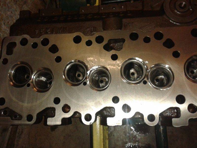

Now look at the finished head.. On the intake side I didn't do much more than blend the valve seat into the head casting, the valve seat boss got narrowed a little on the left side to not make it a "pinch point" in the flow, and the floor of the port got lowered and radiused so the air 'sticks' to the wall and acts more like an airfoil.
On the inside of the cylinder I reduced the angle where the valve recess is which helps low lift flow.
On the exhaust side you can see how I removed a lot of the valve guide boss so it doesn't have any flat area that reflects the pressure wave toward the valve, with the angle it has it directs that pressure wave down the exhaust instead
Here's another angle looking into the intake runner
There are some differences between porting diesels and gas engines, but all the physics behind it stay the same
