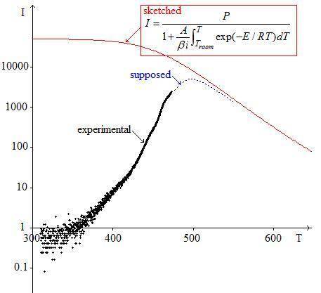

Hi!
Thank you for your answer,
Of course, I can show you the data,
so, here's the plot of a data and data below

Here is a similar plot where the data was fitted on this type of file using equastion writes above
When T is increassing, the integral is increassing, the denominator of the function is increassing, the function is decreassing, which is not consistent with the data. This seems to be the main cause of failure of the fitting.
Since the issue remained outstanding for enough time, I will close it, as far I am concerned.
I cannot help more because the function proposed is not convenient to fit with the given data : any fitting method fails if the general shape of the function is in contradiction with the experimental data.
This is clear on the joint figure : The 1080 experimental points are drawn on logarithmic scale. This is necessary to make visible the scatter in case of large range of magnitude.
The kind of shape of the functions I(T) is sketched (red curve) It is not possible to compute the values of the parameters because there is no experimental point in the convenient range. So, the curve drawn is purely symbolic, only for explanation.
Probably, reconsidering the physical model will lead to a more convenient function.
