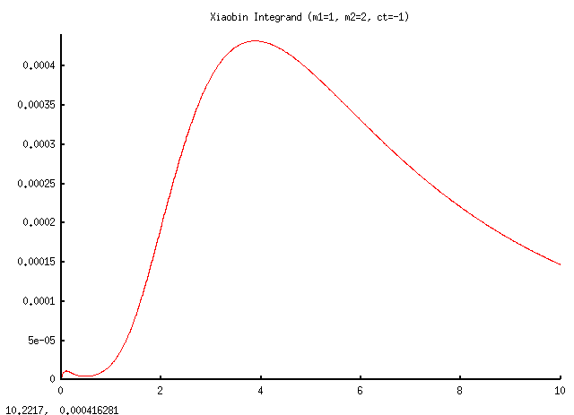

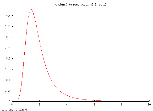

Have you tried plotting the integrand to see how it behaves?
Seems very well behaved, especially if m1 and m2 have to be positive.
Looks like you should get good results representing it as an infinite series.
I've attached these two examples, using gnu-octave with the m-file following.
Code:
% Physical Parameters
m1=1;
m2=2;
ct=1;
P=(1/pi)*exp(-2*(m1*m1+m2*m2));
%coefficients
a=2*m2*m2;
b=4*m1*m2*ct;
c=2*m1*m1;
%r-axis parameters
N=1024;
s=0;
f=10;
%% calculations
r=s:(f-s)/N:f; % r-axis
h=zeros(size(r)); % locate the r axis
u=(a*r.^2 + b*r + c)./(1+r.^2);
v=r./((1+r.^2).^2);
y=P.*(v.*exp(u) + v.*u.*exp(u)); % Integrand
% representation
plot(r,y,"r",r,h,"k");
% tidy up
box
title("Xiaobin Integrand (m1=1, m2=2, ct=1)")

I have already plotted to see its trend.And it really looks like good,and it seems that there should be some kind of expression that can represent this integral.Expanding into series to solve this integral wasn't my purpose honestly.I still think there should have some intricate relationship between the integrand and I just can't figure out a way to kick it.I make me messy these days.How i wish i could solve it.
Well, unless you've made a mistake in the derivation, nature will happily throw up very tough integrals which, even if solveable, will be so only in terms of named classes of functions.
What you really care about is the definite integral so the fine detail of the indefinite integral is not important anyway. Making approximations is a time honored way to make progress.
I think you maybe right,not every integral can be expressed in classical functions.Maybe approximation is the only way to obtain the result.I will try to expand the integrand into series to see whether i can make a approximation.
