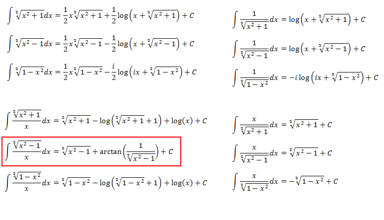

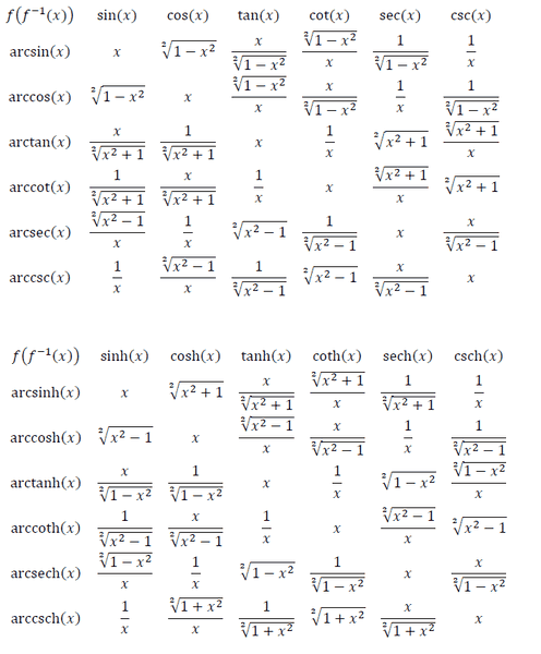

Composing trigonometric functions, you realize that the main substitutions are related with the table below:
So, I started to integrate each expression above and I created this other table:
But I had a problem with the integral circled in red, because I don't know how transform the arctan(...) in other expression that resembles with your adjacentes functions of upper and from below.
[tex]\int \frac{\sqrt{x^2-1}}{x}dx = \sqrt{x^2-1} + \frac{i}{2} \log(x^2 - 2i \sqrt{1-x^2}-2) -i \log(x)[/tex] You have some ideia that how make the integral of ##\frac{\sqrt{x^2-1}}{x}## be similar to integrals of ##\frac{\sqrt{x^2+1}}{x}## and ##\frac{\sqrt{1-x^2}}{x}## ?

Can't see the images clearly, and not entirely sure what you're attempting, but if you just want to get ##\int \frac{\sqrt{x^2-1}}{x}dx##, you're much better off with the sub ##x = \cosh y##.
Or you could use a regular trig substitution, with θ = sec-1(x).

Also, what you have in the upper left corner of the first table is misleading/wrong. f(f-1(x)) = x, as long as x is in the domain of f-1
The idea is only explicit the order of composition.
It's wrong for almost all of the compositions, and it's silly for all of them. The notation f(f-1(x)) is the composition of a function f with its inverse.

[tex]\int \frac{\sqrt{x^2-1}}{x} dx = \sqrt{x^2-1} - i \log(i+\sqrt{x^2-1})+i \log(x)+C[/tex]
I'll leave the check of your antiderivative to you.
A different approach that doesn't involve imaginary numbers follows.
$$ \int \frac{\sqrt{x^2 - 1}dx}{x}$$
Let x = sec(θ), so dx = sec(θ)tan(θ)dθ, and tan(θ) = ##\sqrt{x^2 - 1}##
Using this trig substitution, the integral above becomes
$$ \int \frac{tan(θ)sec(θ)tan(θ)dθ}{sec(θ)}$$
$$ =\int tan^2(θ)dθ = \int (sec^2(θ) - 1)dθ$$
$$ = \int sec^2(θ)dθ - \int 1 dθ$$
$$ = tan(θ) - θ + C$$
Undoing the substitution, the above is equal to
$$\sqrt{x^2 - 1} - sec^{-1}(x) + C$$
If you differentiate the expression above, you get ##\frac{\sqrt{x^2 - 1}}{x}##, the original integrand.
Exist a table of composite functions for sn, cn, sc...?
Does there exist a table like the one you have here? Is that what you're asking? You could probably find one online somewhere if you looked hard enough.
Speaking for myself, I don't have any use for such a table. If I want to simplify, say arcsin(cos(x)), I just draw a right triangle and label the sides and angles appropriately, and work it out.
