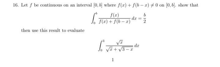

I'm not sure how to go about it tbh :/
On the pic
Do you have any ideas yourself?
Well in the the bottom half I would assume you would have to use u-subsitution but I don't believe the question is asking me to solve the bottom until I prove the top is = b/2?

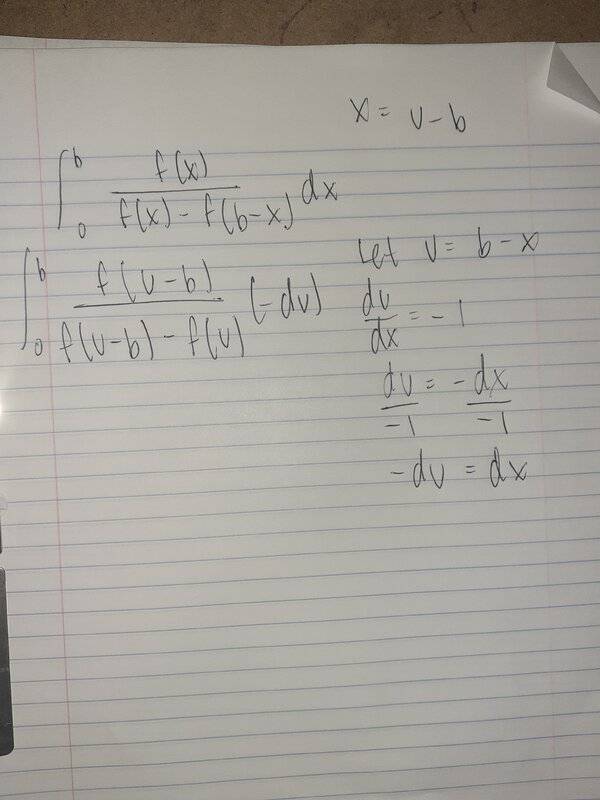

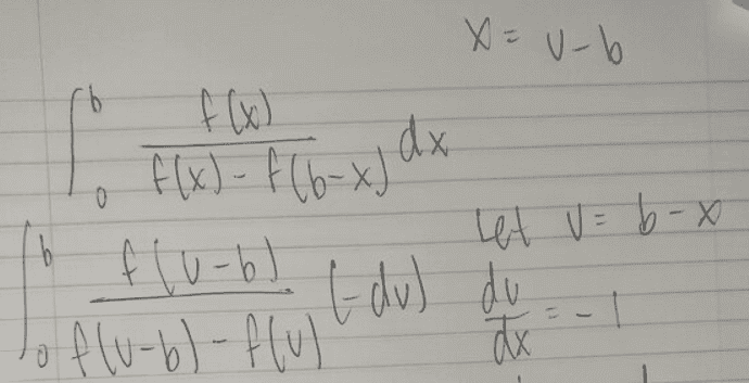

Oh , I'm stuck again. Am I doing it right si far ? :/ I'm sorry it's just confusing to me.
Yes. You need to tidy that up and, strictly speaking, you are missing an equals sign.
You have a few issues to correct.
If ##u=b-x##, then ##x=b-u## not ##u-b##.
The denominator is a sum, ##f(x)+f(b-x)##, not a difference.
The integration limits for ##u## are different than for ##x##.
After making these corrections, there will be more work to do to complete your task.
Likes Delta2
After you do the necessary corrections outlined in post #9 , you ll have the integral $$\int_b^0-\frac{f(b-u)}{f(b-u)+f(u)}du$$, which is the same as $$\int_0^b \frac{f(b-u)}{f(b-u)+f(u)}du$$. Now you ll have to do a little algebraic trick (adding and subtracting from the numerator the same quantity f(u) )and then by algebraic simplifications you ll get a significant result, namely that the initial integral (the integral involving x, let's call it I) is such that $$I=b-I$$. And this is pretty much the end of it, solving the last equation for I.
