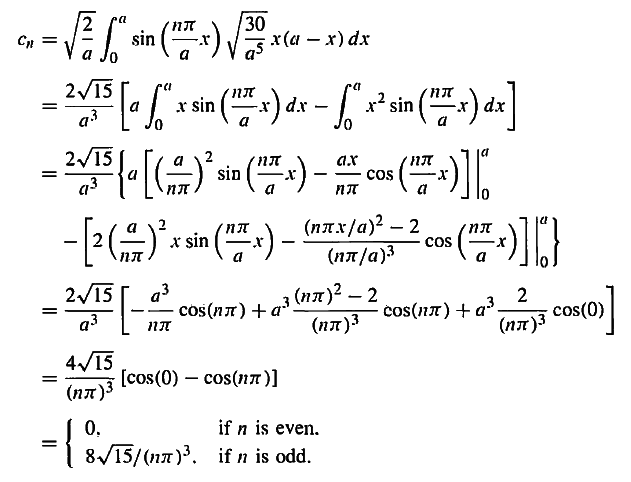

I'm doing a physics problem, but I'm stuck on the math part. My integral is
$$ \frac {2 \sqrt {15}}{a^{3}} \int_{0}^{a} \hspace{0.01 in} sin(\frac {n \pi}{a} x)x(a-x) dx $$
Where ##a## is a constant, and ##n = 1,2,3,...##
I will separate these into two integrals
$$ \frac {2 \sqrt {15}}{a^{3}} \Big [ \int_{0}^{a} ax \hspace{0.01 in} sin(\frac {n \pi}{a}x) dx - \int_{0}^{a} x^{2} \hspace {0.01 in} sin( \frac {n \pi}{a} x) \Big ] dx $$
But from here, I know I could look up on the internet some sort of integral table, but the one I found
Is this integral reasonable to solve by hand, or is it just better to use the table?

I think the author just used a table, not sure if his solution is equivalent to mine

Where did I go wrong in my integration? Everything seems to check out...I overlooked that I got zero, but at least it is connect if ##n## is even...but my solution is for all ##n##
