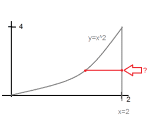

Find the volume of the solid using The Washer Method
[tex]y=x^2, x=2[/tex]
I can solve this problem fine and I don't think my actual question even affects the solution, but I would like to know how one does this.
In my textbook they say to setup the problem on a graph, no problem there. But I am confused on how one obtains the inner line segment.
Actually here is a drawing since I can't explain what I am looking for.
How do you find that red line segment? I would think that would matter in the solution, but it doesn't seem to - at least at my level.
The length of the red line segment is 2 - sqrt(y), which is the difference of the larger x value (2) and the smaller x value (sqrt(y)).
You haven't described the region whose volume you want to find. Is the area you show to be revolved around the x-axis or the y-axis, or even some other line?
From the red line segment you show, it would seem that your region is being revolved around the y-axis.
Got it. And yes it is revolving around the y-axis. I didn't know anything about the red line except it was placed there in my answer book. :)
Each washer has a volume of pi(R(x)^2 - r(x)^2)*delta_y,
[tex]\Delta V = \pi[(R(x)^2 - r(x)^2]\Delta y[/tex]
where R(x) = sqrt(3) and r(x) = sqrt(3 - y^2).
Your washers extend from y = 0 to y = sqrt(3).
