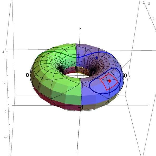

I'd like to integrate a function over a closed circle-like contour around an arbitrary point on a torus and I assume I would use the expression:
$$ \int_{t_1}^{t_2} f(x,y,z) \sqrt{x'(t)^2+y'(t)^2+z'(t)^2}dt$$
And I cannot come up with an explicit parameterization of the variables in terms of t. Here's what I have:
The torus is given by ##\{(R+\rho \cos(\alpha))\cos(\phi),(R+\rho \cos(\alpha))\sin(\phi), \rho \sin(\phi)\}## or ##(x^2+y^2+z^2+b^2-a^2)^2=4b^2(x^2+y^2)##. Let's just use R=2 and ##\rho=1## and let me pick a point on the torus with ##\alpha=\pi/3## and ##\rho=\pi/4##. I now want to draw a small closed circle-like contour around that point on the torus so I'll just use a torus section consisting of a plane slicing through the torus and normal to the surface at the point and a little below it. That plane is given by: $$ n_x(x-a x_1)+n_y(y-a y_1)n_z(z-a z_1)=0$$ with ##a## being a scale factor say ##a=0.9##. The plot below is what that looks like. So where the plane intersects the torus is my blue contour. So that I need $$\int_{\text{blue}} f(x,y,z) \sqrt{x'(t)^2+y'(t)^2+z'(t)^2}dt$$
I can solve for the solution set numerically and then do some curve-fitting for ##x(t),y(t),z(t)##.
So I was wondering if there is a more elegant way to paramaterize x, y and z in this case or how to do the integration in general?
Thanks for reading.

Does the curve have to be circle-like? If not, an easier contour would be a 'rectangle' that follows the iso lines of ##\alpha## and ##\phi##, assuming those are the two coordinates for the surface in an angular coordinate system.
Given your point is ##\alpha=\pi/3,\ \phi=\pi/4##, you could make the curve go around the rectangle with segments:
  • ##\alpha=\pi/6,\ \phi\in[\pi/8,3\pi/8]##
  • ##\alpha\in [\pi/6,3\pi,6],\ \phi=3\pi/8##
  • ##\alpha=3\pi/6,\ \phi\in[\pi/8,3\pi/8]##
  • ##\alpha\in [\pi/6,3\pi,6],\ \phi=\pi/8##
Then the integral is simply the sum of four quasi-linear integrals.
Likes aheight
Thanks! Then I want to show:
$$\int_{\text{blue}} f(x,y,z) \sqrt{x'(t)^2+y'(t)^2+z'(t)^2}dt=\int_{\text{red}} f(x,y,z) \sqrt{x'(t)^2+y'(t)^2+z'(t)^2}dt=0$$
in the plot below where the colors and grid lines reflect a double-cover of the complex plane mapped conformally onto the torus. Should be zero I think. Never did this kind of integration before.

Just want to follow up on that today: I checked it numerically and the integral is virtually zero. The plot below shows the color-coded contour over which I'm integrating. For example, in the case of the red contour, I invert the transforms to obtain ##z(\phi)## using elliptic functions and compute:
$$\int_{\text{Red}} f(z)\frac{dz}{d\phi} d\phi$$
and then the others similiarly, with the sum of theses on the order of ##10^{-17}##. And encouragingly, is also on that order when ##f(z)=\frac{1}{\sqrt{(1-z^2)(k^2-z^2)}}## since the contour does not enclose any of the singular points.
