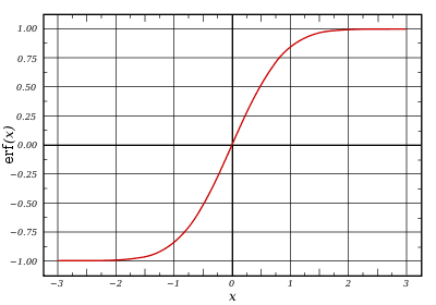

The other way to look at this is to use the definition of the error function:
Then split your integral into 2 sections: [tex]-\infty \rightarrow0 \mbox{ and }0 \rightarrow\infty\\[/tex]
[tex]\int_{-\infty}^{\infty} e^{-x^2} \,dx=\int_{0}^{\infty} e^{-x^2} \,dx-\int_{0}^{-\infty} e^{-x^2} \,dx\\[/tex]
since
[tex]\int_{a}^{b} f(x) \,dx=-\int_{b}^{a} f(x) \,dx\\[/tex].
So your integral becomes
[tex]\lim_{x\to\infty}\, (erf(x)-erf(-x))\frac{\sqrt{\pi}}{2}[/tex]
which is [tex]\sqrt{\pi}[/tex] because [tex]\lim_{x\to\infty}\, erf(x) = 1 [/tex] and [tex]\lim_{x\to-\infty}\, erf(x) = -1 [/tex]
