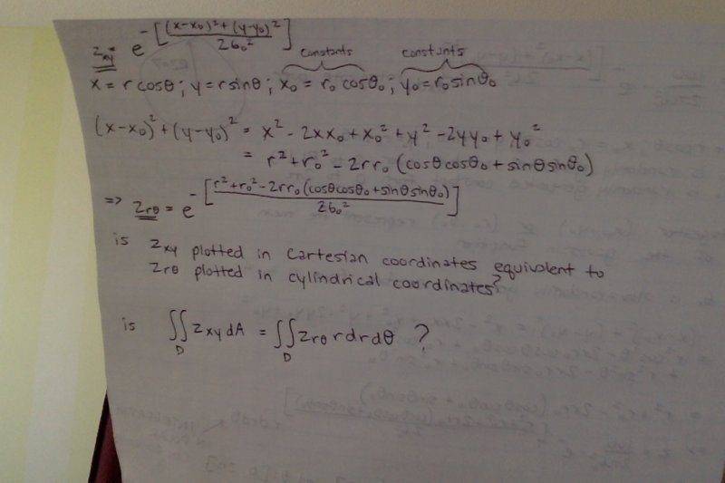

I have a 2D Gaussian:
## f(x,y) = e^{-[(x-x_o)^2 + (y-y_o)^2]/(2*{sigma}^2)}##
which I converted into polar coordinates and got:
## g(r,θ) = e^{-[r^2 + r_o^2 - 2*r*r_o(cos(θ)cos(θ_o) + sin(θ)sin(θ_o))]/({2*{sigma}^2})} ##
The proof for how this was done is in the attached file, and it would be great if someone could verify my steps in case I messed up somewhere. I have plotted the functions, and they do seem comparable by visual inspection.
The characteristics of the functions (including ## sigma_o##) are manually specified by me, so the values for ##x_o##, ##y_o## match up with ##r_o## and ##θ_o##. Now, when I integrate these functions over the same regions, I don't always get the same answers. For example, when ##r = 0## or ##θ = 0##, I do get the same answers, but when ##θ != 0##, then the answers are slightly off. I have been trying to search for where I'm going wrong, and it may completely obvious (likely associated with the sine and cosine terms), but I'm just not seeing it. The fact that the values from completing the integration on Python (in polar coordinates) and WolframAlpha (in cartesian coordinates) are relatively similar for the cases where ##θ != 0## seems a little odd to me. If anyone has any thoughts, it would be greatly appreciated!
Here is my code:

What do you mean with relatively similar?
Numeric integration will always lead to small errors, and those are different for different parametrizations. It would be surprising if the results match "exactly".
Do you have some examples?
