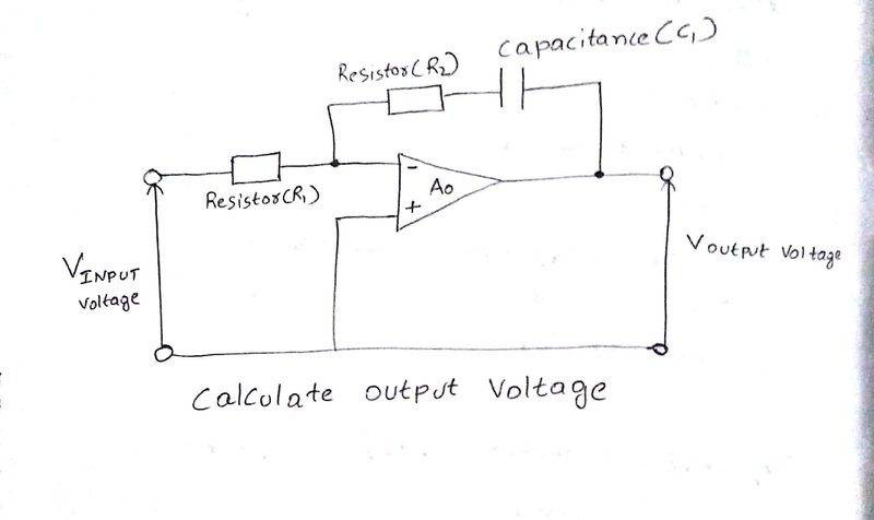

Calculate the output voltage of the amplifier
2. Homework Equations
[/B]
https://www.electronics-tutorials.ws/opamp/opamp32.gif
I do not know how to approach a circuit with RC in series to inverting terminal of integrating op amp
You still write the KCL equation at the "-" input to the opamp. The impedance to the right is just the sum of the impedances of the resistor and capacitor. Can you show us that equation and then how you would solve it to get Vo/Vi? :smile:

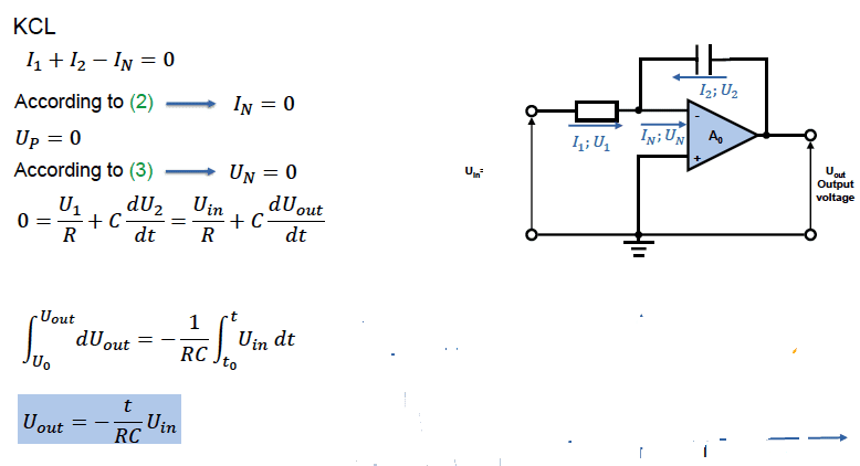

yeah i can do it when its standard integrating op amp circuit but when a resister ans capacitor is added(see below image) to the inverting terminal in feedback then i don't know how to form equation
