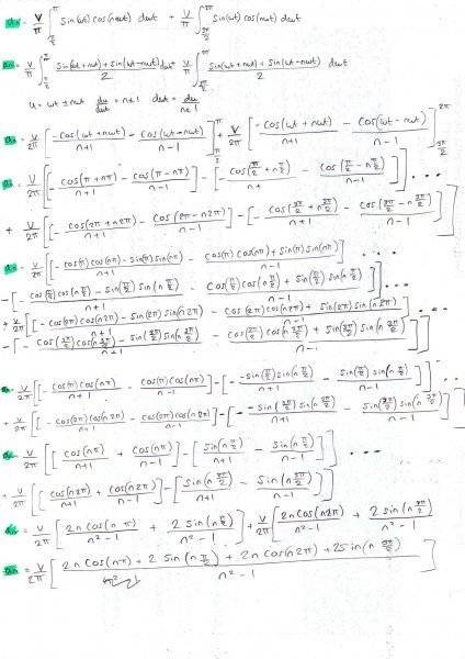

I am trying to work out the Fourier coefficient [itex]a_{n}[/itex] for :
Mathematics is not my strong point and I would appreciate some help. The answer that wolfram spits out it lovely and neat and I am struggling to get my answer to it.
Apologies for the messy scan, its the best I can do without typing out ALL my working out in LaTeX.
I am really trying to improve my mathematics, so any suggestions on making my expressions neater, or techniques I may have missed, please do let me know.
EDIT : it seems uploading has resized my scan.
heres a https://drive.google.com/file/d/0B9RrInHrjRJCbTJBS0RqYlJHSW8/view?usp=sharing
Thanks for your time

Hello EL,
What Fourier series does Wolfram find ? If I fill in n=1 in the expression in the link I don't think I get a useful coefficient.
It may be lovely and neat, but is it the correct answer for what you are after ?
You are looking for ## a_n##, using
for a function that is defined from ##0## to ##2\pi##. (Which is also the range you ask Wolfram to integrate over).
But you also post
Does this mean you already know ##b_n=0## or will the sine series come later ?

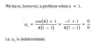

Hi BvU,
The wolfram link I gave is just for the [itex]a_{n}[/itex]. It is indeterminate at [itex]a_{1}[/itex] and zero for all even numbers thereon. This is fine and to be expected. I have not got round to starting [itex]b_{n}[/itex], I would like to get [itex]a_{n}[/itex] to a workable expression( of [itex]n[/itex]) first. At this moment I am not concerned with the Fourier series, just the integral mathematics in working out [itex]a_{n}[/itex]. Have you had a chance to look at my working out for [itex]a_{n}[/itex], does it seem like its on the right track?

Hello again,
I find it hard to believe a Fourier coefficient can be indeterminate, so I don't think that the elegant result you got from Wolfram is what you where looking for. Check their function "Fourier cos series" (instead of int, and you also remove the *cos etc at the end).
I can't read your jpg and If I could, then I still can't point to places where I would have questions or remarks. How about if you TeX the first step(s) of what you are trying to do, so we can go over things like:
what you are trying to integrate
continuation of the function outside [0,2pi]
limits
a few simple cases (n = 1, 2, ...)
generalization
This is the example I am following about the a1 being indeterminate...
Here is the first leg of the calculations : [itex]\displaystyle a_{n} = \frac{V}{\pi}\int_{\frac{\pi}{2}}^{\pi}\sin(\omega t)\cos(n\omega t) \delta\omega t + \frac{V}{\pi}\int_{\frac{3\pi}{2}}^{2\pi}\sin(\omega t)\cos(n\omega t)\delta\omega t[/itex]
So in the first step I have evaluated that between 0 and pi/2 the function equals zero and is omitted, same as with pi to 3pi/2. V has been brought outside the integral.
[itex]\displaystyle \frac{V}{2\pi}\int_{\frac{\pi}{2}}^{\pi}\sin(\omega t+n\omega t)+\sin(\omega t -n\omega t)\delta\omega t + \frac{V}{2\pi}\int_{\frac{3\pi}{2}}^{2\pi}\sin(\omega t+n\omega t)+\sin(\omega t -n\omega t)\delta\omega t[/itex]
In step two I have used the "product to sum" identity
[itex]\displaystyle \sin\alpha\cos\beta = \frac{1}{2}[\sin(\alpha+\beta)+\sin(\alpha-\beta)][/itex]
[itex]\displaystyle u=\omega t \pm n\omega t \\ \delta u = n \pm 1 \\ \delta\omega t = \frac{\delta u}{n\pm 1}\\ \\ \frac{V}{2\pi}\Big[-\frac{\cos(\omega t + n \omega t)}{n+1} - \frac{\cos(\omega t - n \omega t)}{n-1} \Big]_{\frac{\pi}{2}}^{\pi} + \frac{V}{2\pi}\Big[-\frac{\cos(\omega t + n \omega t)}{n+1} - \frac{\cos(\omega t - n \omega t)}{n-1}\Big]_{\frac{3\pi}{2}}^{2\pi} \\[/itex]
Step 3 I have integrated by parts
[itex]\displaystyle \frac{V}{2\pi}\Bigg[\Big[-\frac{\cos(\pi + n \pi)}{n+1} - \frac{\cos(\pi - n \pi)}{n-1} \Big] - \Big[-\frac{\cos(\frac{\pi}{2} + n \frac{\pi}{2})}{n+1} - \frac{\cos(\frac{\pi}{2} - n \frac{\pi}{2})}{n-1} \Big]\Bigg] + \frac{V}{2\pi}\Bigg[\Big[-\frac{\cos(2\pi + n 2\pi)}{n+1} - \frac{\cos(2\pi - n 2\pi)}{n-1} \Big] - \Big[-\frac{\cos(\frac{3\pi}{2} + n \frac{3\pi}{2})}{n+1} - \frac{\cos(\frac{3\pi}{2} - n \frac{3\pi}{2})}{n-1} \Big]\Bigg][/itex]
step 4 expanding out the limits
[itex] \displaystyle \frac{V}{2\pi}\Bigg[\Big[-\frac{\cos(\pi)\cos(n\pi)- \sin(\pi)\sin(n\pi)}{n+1} - \frac{\cos(\pi)\cos(n\pi)+ \sin(\pi)\sin(n\pi)}{n-1} \Big] - \Big[-\frac{\cos(\frac{\pi}{2})\cos(n\frac{\pi}{2})- \sin(\frac{\pi}{2})\sin(n\frac{\pi}{2})}{n+1} - \frac{\cos(\frac{\pi}{2})\cos(n\frac{\pi}{2})+ \sin(\frac{\pi}{2})\sin(n\frac{\pi}{2})}{n-1} \Big]\Bigg] + \frac{V}{2\pi}\Bigg[\Big[-\frac{\cos(2\pi)\cos(n2\pi)- \sin(2\pi)\sin(n2\pi)}{n+1} - \frac{\cos(2\pi)\cos(n2\pi)+ \sin(2\pi)\sin(n2\pi)}{n-1} \Big] - \Big[-\frac{\cos(\frac{3\pi}{2})\cos(n\frac{3\pi}{2})- \sin(\frac{3\pi}{2})\sin(n\frac{3\pi}{2})}{n+1} - \frac{\cos(\frac{3\pi}{2})\cos(n\frac{3\pi}{2})+ \sin(\frac{3\pi}{2})\sin(n\frac{3\pi}{2})}{n-1} \Big]\Bigg][/itex]
step 5 i have used the sum and difference formula:
[itex]\displaystyle\cos(\alpha\pm\beta) = \cos\alpha\cos\beta \mp \sin\alpha\sin\beta[/itex]
[itex] \displaystyle \frac{V}{2\pi}\Bigg[\Big[-\frac{\cos(\pi)\cos(n\pi)}{n+1} - \frac{\cos(\pi)\cos(n\pi)}{n-1} \Big] - \Big[-\frac{- \sin(\frac{\pi}{2})\sin(n\frac{\pi}{2})}{n+1} - \frac{ \sin(\frac{\pi}{2})\sin(n\frac{\pi}{2})}{n-1} \Big]\Bigg] + \frac{V}{2\pi}\Bigg[\Big[-\frac{\cos(2\pi)\cos(n2\pi)}{n+1} - \frac{\cos(2\pi)\cos(n2\pi)}{n-1} \Big] - \Big[-\frac{- \sin(\frac{3\pi}{2})\sin(n\frac{3\pi}{2})}{n+1} - \frac{ \sin(\frac{3\pi}{2})\sin(n\frac{3\pi}{2})}{n-1} \Big]\Bigg][/itex]
step 6 I have canceled out the zero cosine and sine terms
[itex] \displaystyle \frac{V}{2\pi}\Bigg[\Big[\frac{\cos(n\pi)}{n+1} + \frac{\cos(n\pi)}{n-1} \Big] - \Big[\frac{\sin(n\frac{\pi}{2})}{n+1} + \frac{ \sin(n\frac{\pi}{2})}{n-1} \Big]\Bigg] + \frac{V}{2\pi}\Bigg[\Big[-\frac{\cos(n2\pi)}{n+1} - \frac{\cos(n2\pi)}{n-1} \Big] - \Big[-\frac{ \sin(n\frac{3\pi}{2})}{n+1} + \frac{ \sin(n\frac{3\pi}{2})}{n-1} \Big]\Bigg][/itex]
Step 7 canceled out the 1 and -1 terms
[itex] \displaystyle \frac{V}{2\pi}\Bigg[\frac{2n\cos(n\pi)-2n\sin(n\frac{\pi}{2})-2n\cos(n2\pi)+2\sin(n\frac{3\pi}{2}))}{n^2-1}\Bigg][/itex]
step 8 consolidated
Here is where I am stuck to carry on...

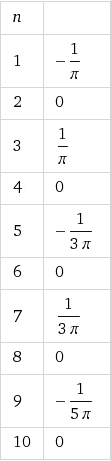

inputting my last expression into a wolfram table reveals ...LINK
In comparison to LINK which is an answer given in a previous topic on PF ...LINK
Somewhere I have made a mistake!
Thanks again
EL

You left out a factor of n from the coefficient of the last sine term in the numerator.
It should be ## \ 2n\sin(n\frac{3\pi}{2}) \ ##.
Added in Edit:

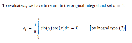

To find a_1, simply put n = 1 in the integral expression. Then evaluate that.
Link to Wolfram inserting n = 1 in your original expression.

I think I was mainly looking at patterns, but now that you mention it: There is an error going from step 5 to step 6..
In eqach of the two groups of expressions with sin() , the sines have opposite sign. That is what cancels n & gives a two.
So in step 6, that first sin() expression should not have a coefficient n, just 2 .

The part of step 5 I was referring to is:
##\displaystyle \ - \left[-\frac{- \sin(\frac{\pi}{2})\sin(n\frac{\pi}{2})}{n+1} - \frac{ \sin(\frac{\pi}{2})\sin(n\frac{\pi}{2})}{n-1} \right] \ ##
What you should have for the corresponding part of step 6 is:
##\displaystyle \ - \left[\frac{\sin(n\frac{\pi}{2})}{n+1} - \frac{ \sin(n\frac{\pi}{2})}{n-1} \right] \ ##
not
##\displaystyle \ - \left[\frac{\sin(n\frac{\pi}{2})}{n+1} + \frac{ \sin(n\frac{\pi}{2})}{n-1} \right] \ ##

The new expression yields almost identical results to the compared answer, except my results are all negative.
my results:
n=1 gives indeterminate
n=3 gives -v/pi
n=5 gives -v/(3*pi)
n=7 gives -v/(3*pi)
n=9 gives -v/(5*pi)
In comparison to the "answer" table
LINK
Also... a comparison between the actual expression worked out by wolfram LINK
Compared with my final expression simplified in wolfram LINK

I get the impression that you're stumped in two ways. One is the indeterminate nature of coefficient, a1 . The other is that you're not quite producing the correct values for the other coefficients.
Let's look at what's going on with a1.
earthloop said:
##\displaystyle \frac{V}{2\pi}\int_{\frac{\pi}{2}}^{\pi}\sin(\omega t+n\omega t)+\sin(\omega t -n\omega t)\delta\omega t + \frac{V}{2\pi}\int_{\frac{3\pi}{2}}^{2\pi}\sin(\omega t+n\omega t)+\sin(\omega t -n\omega t)\delta\omega t##
[itex]
\displaystyle u=\omega t \pm n\omega t \\ \delta u = (n \pm 1)\color{red}{\delta\omega t} \\ \delta\omega t = \frac{\delta u}{n\pm 1}\\ \\ \frac{V}{2\pi}\Big[-\frac{\cos(\omega t + n \omega t)}{n+1} - \frac{\cos(\omega t - n \omega t)}{n-1} \Big]_{\frac{\pi}{2}}^{\pi} + \frac{V}{2\pi}\Big[-\frac{\cos(\omega t + n \omega t)}{n+1} - \frac{\cos(\omega t - n \omega t)}{n-1}\Big]_{\frac{3\pi}{2}}^{2\pi} \\
[/itex]
Step 3 I have integrated by parts (By the Way: This is simply u-substitution, not integration by parts.)
[itex]
[/itex]
Thanks again
EL
I did suggest in a previous post, that you simply evaluate you're initial integral directly with a value of 1 inserted for n.
but...
Let's what it is about n = 1 that causes the general result you have to be in error. (the indeterminate thing)
It's just the (n-1) factor which produces the problem. So let's consider the following indefinite integral.
##\displaystyle\ \int \sin(\omega t -n\omega t)\delta\omega t ##​
First of all, if n = 1, then the integrand becomes sin(0) which is zero, thus the definite integral resulting from this is zero.
If you consider the substitution, ##\ u=\omega t - n\omega t\ ##, you get ##\displaystyle\ \delta u = (1-n)\delta\omega t\ ##. (Maybe this is the source of your sign error.)
When you solve for ##\ \delta\omega t\ ##, you get ##\displaystyle\ \delta\omega t = \frac{\delta u}{1-n}\ ##.
See the problem if n = 1 ?
Ok yes, got it, thanks for that! I can see how [itex]a_{1}=-\frac{v}{pi}[/itex]. Sadly I haven't had a time today to check my expression, but I will tomorrow, I'm sure I will find the mistake!

I now have simplified the expression as much as I can to
[itex]\displaystyle\frac{v\bigg(\cos(n\pi)+n\sin(n\frac{\pi}{2})-\cos(n2\pi)-n\sin(n\frac{3\pi}{2})\bigg)}{\pi(1-n^2)}[/itex]
Yet wolfram still simplifies it even more into :
[itex] - \frac{2\, v\, \sin\!\left(\frac{n\, \mathrm{\pi}}{2}\right)\, \left(\sin\!\left(\frac{3\, n\, \mathrm{\pi}}{2}\right) - n\, \cos\!\left(n\, \mathrm{\pi}\right)\right)}{\mathrm{\pi}\, \left(n^2 - 1\right)}[/itex]
Any idea how it achieved this? A trig identity? I couldn't see where any would help me.
After this I'll be well prepared for working out [itex]b_{n}[/itex]! :woot:
Thanks again
EL
earthloop said:
Ok I have managed to get the correct results, after correcting the substitution to 1-n and rewriting the expression. Thanks for your help!
Thanks again
EL
Difference to product.
Ah ok got it now. Thanks very much for all the help!
EL
