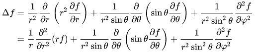

See this for spherical coordinates on mathworld:
And from wiki for cylindrical:
In any case, the problem you mention with the 1−e−... would not occur because of the expression for the Laplacian.
Where did you get your expression for the Laplacian?

I'm sorry, you were right, you have the correct equation. When expanded it becomes two terms on the left-hand side:
## d^2V/dr^2+(2/r)dV/dr = −ρ/ϵ ##
in mks units (Ihave forgotten cgs if that's what you were using).
I will repond again when and if I can be of further help.
I believe you should keep your equation as is.
Then you can integrate rV twice:
## d(rV)/dr = (-1/\epsilon) \int\rho(r) \, dr + C_1 = - (1/\epsilon) f(r) + C_1 ##
## rV = (-1/\epsilon) \int f(r) \, dr + C_1r + C_2 ##
then divide lhs & rhs by r to get V(r)
so you need to know V(r) at some value of r in addition to r = infinity, for example at r = a.
The radial component of the spherical laplacian that you posted is equal to that of my formula.
I'm writing from my mobile now and it's a bit weird to write latex so I won't post a proof here, but you can easily write both of these expressions as
\frac2r\frac{\partial}{\partial r} + \frac{\partial^2}{\partial r^2}
which means they are identical. (Notice I already multiplied by ##r## on both sides of my Poisson's eq.)
