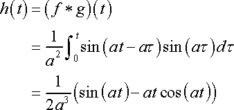

I have the answer I just don't know how he got it! I want to know how he got from the second line to the third line in the image below.
I have used integration by part and the u substitution method.
When substituting with u i am still left with the other terms in the other sine function.
When integrating by parts, it just doesn't simplify..
Is there another method i don't know about? There doesn't seem to be any trig identities either.

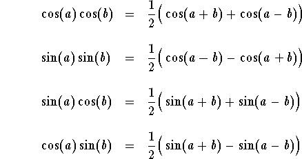

Hi & welcome to PF!
Use the product to sum formulae:
Regards.
ok, that seems to be the way to go (i must remember these)
but i am still having problems evaluating it...

[tex]\sin(at-a\tau)\sin(a\tau) = ?[/tex]
[tex]sin(at-a\tau)sin(a\tau) = \frac{1}{2}(cos(at-a\tau-a\tau) - cos(at-a\tau+a\tau)) = \frac{1}{2}(cos(at-2a\tau) - cos(at))[/tex]
subbing this into the integral and taking the half outside:
[tex]\frac{1}{2a^2}( \int cos(at-2a\tau) d\tau - \int cos(at) d\tau )[/tex]
i treated cos(at) as a constant because we are integrating with respect to tau, not t...
or is this where i am going wrong?

Actually, you forgot the limits. So your integral would be:
[tex]\frac{1}{2a^2}( \int_{0}^{t} cos(at-2a\tau) d\tau - \int_{0}^{t} cos(at) d\tau)[/tex]
Now make a substitution,
- for the first integral [itex]w=at-2a\tau[/itex]
- for the second integral treat cos(at) as constant, so that:
[tex]\frac{1}{2a^2}( \int_{0}^{t} cos(at-2a\tau) d\tau - cos(at)\int_{0}^{t} d\tau)[/tex]
Now find dw but do not forget the limits of the integral. You need to substitute 0, t for tau, in w.

As I said, again you missed the limit.
[tex]\frac{1}{2a^2}( \int_{0}^{t} cos(at-2a\tau) d\tau - cos(at)\int_{0}^{t} d\tau) [/tex]
let [tex]u = at-2a\tau[/tex]
[tex]\frac{du}{d\tau} = -2a[/tex]
[tex]\frac{du}{-2a} = d\tau[/tex]
Now, for [itex]\tau=0[/itex], u=at and for [itex]\tau=t[/itex], u = at-2at=-at
So your integral should look like: [tex]
\frac{1}{2a^2}(\frac{1}{-2a} \int_{at}^{-at} cos(u) du - cos(at)\int_{0}^{t} d\tau)
[/tex]
Be careful with those limits!

That help! Thankyou! You don't know how long i have been trying to figure this out.
you posted the limits the wrong way round, but you probably mixed them up when you typed it into the brackets {}{}..
[tex]\frac{1}{2a^2}(\frac{1}{-2a} \int_{at}^{-at} cos(u) du - cos(at)\int_{0}^{t} d\tau) [/tex]
[tex]\frac{1}{2a^2}(\frac{1}{-2a} \int_{at}^{-at} cos(u) du - cos(at)(t-0)) [/tex]
[tex]\frac{1}{2a^2}(\frac{1}{-2a} \int_{at}^{-at} cos(u) du - tcos(at)) [/tex]
[tex]\frac{1}{2a^2}(\frac{1}{-2a} (sin(-at) - sin(at)) - tcos(at)) [/tex]
[tex]\frac{1}{2a^2}(\frac{1}{-2a} (- sin(at) - sin(at)) - tcos(at)) [/tex]
[tex]\frac{1}{2a^2}(\frac{1}{a} (sin(at) - tcos(at)) [/tex]
[tex]\frac{1}{2a^3}(sin(at) - atcos(at) [/tex]
Thanks again. I can now sleep knowing how he does it now! ;)
Yep, you did it right. :smile:
Regards.
