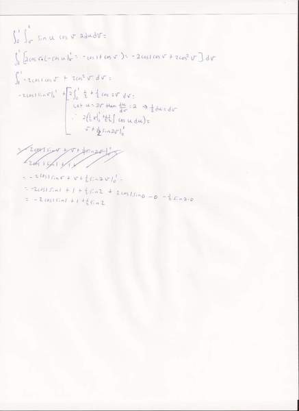

Evaluate double integral R of sin((x+y)/2)*cos((x+y)/2), where R is the triangle with vertices (0,0), (2,0), and (1,1) using change of variables u = (x+y)/2 and v = (x-y)/2
Are my integrands correct? I'm getting the wrong answer...the solution is 1 - (sin 2)/2 but I'm getting 1 + (sin2)/2 - 2cos(1)sin(1)
(1) Solve for x and y using the change of variables and you get y = u-v and x = u+v. Convert the (x,y) coordinates into (u,v) coordinates and for (u,v) coordinates you get new vertices (0,0), (1,1), and (1,0).
(2) SOlve for the Jacobain factor --> Factor = 2.
(3) Set up the integral: so according to the new triangle in (u,v) coordinates we see that v ranges from 0 to 1 and u ranges from v to 1. So we we have the double integral of where integral of v =(0,1), integral of u = (v,1) sin(u)*cos(v) 2dudv.
I know I have the right set up, but according to the solution, my error lies in setting up the integrals. Please help. I know this is like my 3rd question in two days =(
The integral you set up will lead to the correct answer, so you're apparently just not calculating it correctly. Show us how you evaluated the uv integral.
Attempt is attached

Sorry, you haven't made a mistake. You just don't recognize you have the right answer. You want to use the trig identity [itex]\sin 2\theta = 2 \sin \theta \cos \theta[/itex] to get
[tex]1+\frac{\sin 2}{2}-2\sin 1\cos 1 = 1+\frac{\sin 2}{2} - \sin 2 = 1 - \frac{\sin 2}{2}[/tex]
Thank you Vela so much!
