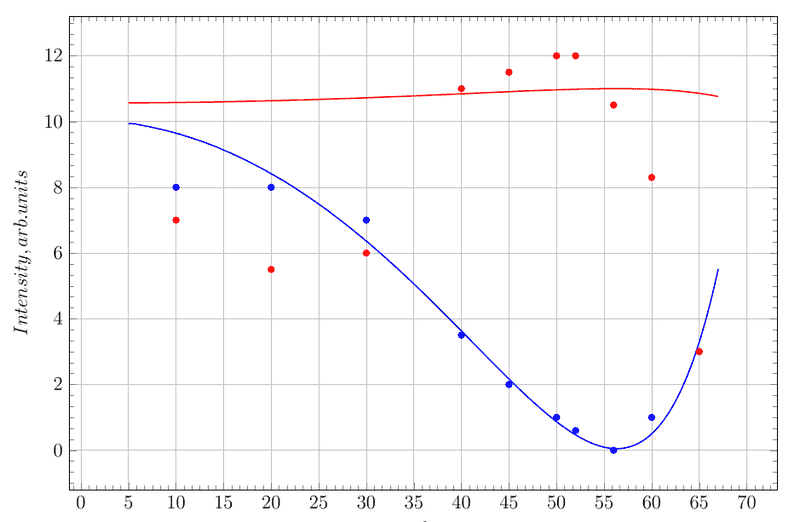

Suppose, we sent p-polarized light to a stack of plates (10 plates with $n = 1.5$).
I expected the intensity of reflected p-polarized light subject to equation (1) and also the intensity of p-polarized light passed across stack of plates subject to equation (2) with some downgrading due to absorption.
I get an experimental data in picture:
\begin{filecontents}{plate.dat}
angle refracted reflected
7 8 10
5.5 8 20
6 7 30
11 3.5 40
11.5 2 45
12 1 50
12 0.6 52
10.5 0 56
8.3 1 60
3 3 65
\end{filecontents}The best fit reflected p-polarized light (blue line) is
\begin{equation}\label{fita}
\frac{I_{p_{refl}}}{250}=\frac {\tan^{2}(i-r)}{{\tan^{2}(i+r)}}
\end{equation}
It seems reasonable.
But fit with equatuion (2) looks bad (red line) :
\begin{equation}\label{fitb}
\frac{I_{p_{refr}}}{1/n\cdot 250}=1 - \frac {\tan^{2}(i-r)}{{\tan^{2}(i+r)}}
\end{equation}
I have no idea how to explain it.

Multiple reflections are somewhat difficult to take into account using these equations, but the transmitted intensity for 10 plates should be approximately ## \tau_{ten}=\tau_{single}^{10} ##.(This equation is only a rough approximation and doesn't take the transmission from multiple reflections into account.) From looking at your data, I don't think absorption losses account for a tremendously high percentage. Instead, the transmission through the 10 plates at and near the Brewster angle appears to be quite high (near 100%), but I think you normalized the intensity rather than displaying absolute transmittance. ## \\ ## Editing: I would also suggest you check the equations and how they might apply. The Fresnel equations are normally for a single dielectric interface. If you have 10 plates, that could be as many as 20 air/material dielectric interfaces, rather than 10.
