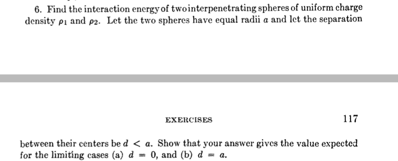

Find the interaction energy of two interpenetrating spheres of uniform charge density $$\rho_{1}$$ and $$\rho_{2}$$ Let the two spheres have equal radii $a$ and let the separation.

I am trying to calculate the interaction energy of two interpenetrating spheres of uniform charge density. Here is my work:
First I want to calculate the electric potential of one sphere as following;
$$\Phi(\mathbf{r})=\frac{1}{4 \pi \epsilon_{0}} \int \frac{\rho\left(\mathbf{r}^{}\right)}{\bf{r^{\prime}}} d \tau$$
Doing that I got
$$\Phi(r)= \frac{\rho}{2 \epsilon_{0}}\left(R^{2}-\frac{1}{3} r^{2}\right)$$
Now I need to solve the following;
$$\int_{V} \rho_{2}(\vec{r}) \Phi_{1}(\vec{r}) \mathrm{d}^{3} r$$ But I did not know how to do it.
I general,
$$U_{i n t}=\frac{}{} \int_{V} \rho_{2}(\vec{r}) \Phi_{1}(\vec{r})+\rho_{1}(\vec{r}) \Phi_{2}(\vec{r}) \mathrm{d}^{3} r=\int_{V} \rho_{1}(\vec{r}) \Phi_{2}(\vec{r}) \mathrm{d}^{3} r=\int_{V} \rho_{2}(\vec{r}) \Phi_{1}(\vec{r}) \mathrm{d}^{3} r$$
which tells that the total work done by one sphere on the other sphere as you bring the isolated objects from super far away to their current positions. Since the forces were equal and opposite, the work done by one on the other is equal to the work done by the other on the one.
Please help me. I attached the problem statement.

Draw the diagram showing two equal overlapping circles, centres A and B.
(According to the question, each centre lies inside the other circle, though I suspect a mistake here. I think they meant d<2a, not d<a. Correspondingly, the "extreme case" where the value is well known should be at d=2a.)
Now draw a thin spherical cap, thickness dr, radius r<a centred on A and lying inside the other sphere (extending to its surface).
What is the potential at this cap due to the charge on sphere A? This will require integration, but it's easy.
What is the volume of this cap? An easy way to get this is to use the way Archimedes found the surface area of a sphere without quite inventing calculus.
What is the potential energy of the cap in respect of the charges on it and on the sphere A?
Integrate to get the total for r<a, then follow the same procedure for r>a.
