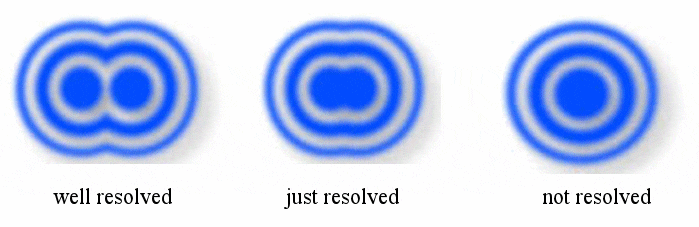

David Byrden said:
An image of the slits looks like two bright lines.
If you have the conditions for interference, and you stand in the light zone and look back at the slits, you will not see two bright lines. I couldn't find a picture with lines, but with dots (figure from the University of Tennessee at Knoxville) it will look like the figure on the right, not the left:
On the experiment presented by the OP, suggestion is to use a lens as opposed to a telescope. ## \\ ## If the paint stripes on the lens are placed on the bright stripes of the interference pattern at 2 meters, the energy is basically wiped away, so very little energy will be observed past this region. Any observations done in the region beyond the lens will receive very little energy. ## \\ ## If the opaque paint stripes are placed in front of the dark regions of the two-slit pattern at 2 meters, they will have little effect, and the results would be similar as if there were no paint stripes at all. ## \\ ## It's all a completely classical description.
Vanadium 50 said:
If you have the conditions for interference...it will look like the figure on the right, not the left:
Thank you. But my proposal was to substitute a larger lens/telescope/instrument until the image resolves. Is that not possible?
David
No. That just makes the picture I posted bigger.

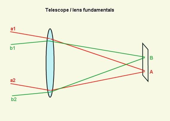

DrChinese said:
Logically, the interfering light paths are meeting at the same point where it enters the telescope. And that light has but a single path through the telescope to your eye.
No, that's not how telescopes work.
David

2. No, that's not how telescopes work.
1. When there is interference, there are bands that appear strongly that do not much appear otherwise (when there is no interference, you are not investigating the "no interference" case). So this is where you will place a telescope. You hope to "resolve" the one true path, as you believe there secretly exists which-slit information that your telescope can detect.
2. That's not how light travels. There will be only 1 path through the telescope, not 2. That's because it arrives at a point when it enters the telescope. That point being a place where there is interference from the 2 slits. One effective path to your eye. Keep in mind that if there is interference, by definition it did not go through one slit or the other. It went through "both"*.*Unless you are a Bohmian. :smile:

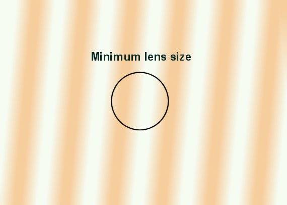

  • #32
DrChinese said:
there are bands that appear strongly...So this is where you will place a telescope.
This is how the minimum-size lens sits on the interference bands. It's not possible to place it exclusively in a "strong" band. At least one strong band and one weak band will fall on it. And with this lens, the image of the slits is just about discernible. We would need a larger lens for good clarity.
Much more significant : it's not possible for the telescope to detect the interference pattern by shifting across it.
Because it's large enough to detect the which-way info, it's too large to sense the interference bands.
(All right, I agree, the lens can slightly sense the band pattern if its diameter is not an exact multiple of the band spacing. But by the same token, it forms an image of the slits that is somewhat blurred, so it can't deduce which-way info for all the incoming photons. There is a tradeoff.)
