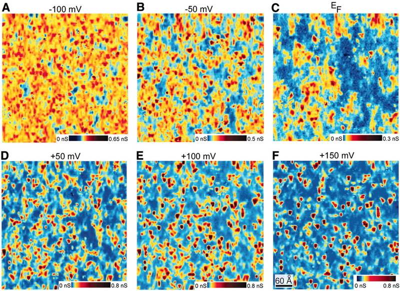

In contrast, quantum mechanics predicts strongly localized (Anderson) probability distribution, prisoning the electrons and preventing conductance. Here are examples of electron density graphs for surface of semiconductor from 2010 Science article (its slides) using tunneling microscope (STM) - having complex localized patterns:
This disagreement enforced the quantum view: with interfering waves of electrons.

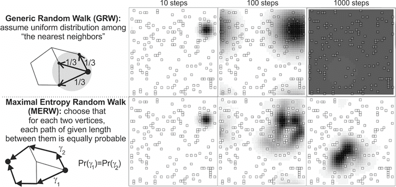

However, it turns out that standard diffusion models often only approximate the (Jaynes) principle of maximum entropy: "the probability distribution which best represents the current state of knowledge is the one with largest entropy", required by statistical physics models. This approximation is repaired in Maximal Entropy Random Walk (MERW), which turns out to have the missing localization property (PRL article) - leads to stationary probability distribution exactly as predicted by QM: of quantum ground state.
Here is example of evolution of standard random walk (GRW) and MERW on 40x40 lattice with cyclic boundary conditions, which is defected: all but marked vertices (squares) have additional self-loop (degree is 4 or 5):
So MERW can be seen as some "quantum correction to diffusion models", e.g. here is a simple semiconductor simulator. However, it is not QM, it completely ignores interference-like phenomena. But while complete quantum conductance calculations are usually too expensive for our computers, MERW-based diffusion is relatively accessible, still having some crucial quantum properties - the question is importance of interference this approximation neglects.

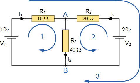

However, in standard macroscopic electronics the situation is quite clear - using two Kirchhoff's laws we can write set of equation and get electric currents, e.g.
The found currents allow to answer questions: what percentage of electrons flow through a given wire,
or for a fork: what is probability of electron choosing a given path ... so mathematician would say that we have a stochastic model for electron behavior.
