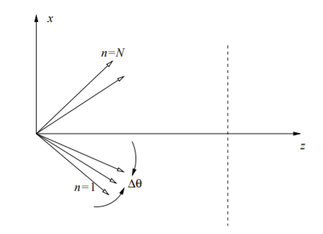

A fan of ##N## plane waves are propagating symmetrically with respect to the z axis, as shown in figure below. The angular spacing between successive members of the fan is fixed and equal to ##\Delta \theta##. Describe the interference pattern observed on a plane perpendicular to the z axis.

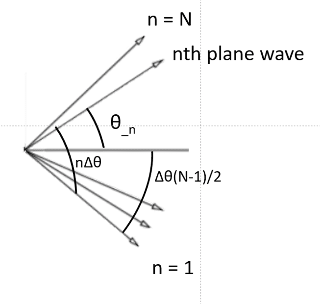

So I've kind of made the assumption that there will be an odd number of plane waves and the same amount above and below the z-axis. Then, using the diagram below, I determined the angle the nth plane wave makes with respect to the z-axis to be the angle it makes with respect to the n =1 plane wave, ##n \Delta \theta##, minus the 1/2 the total angle between the n = N and n = 1 plane waves, ##\Delta \theta \frac {(N - 1)} {2} ##, giving me ##\theta_n = \Delta \theta (n - \frac {N - 1} {2} ) ##. Angles below the z-axis are negative and above are positive. Therefore, ## \theta_n = -\theta_{n - \frac {N - 1} {2}}## for ## n > \frac {N - 1} {2} ##.
Making the assumption that they all have the same wavelength (and hence wavenumber ##k## and amplitude, the nth plane wave would be of the form (also ##\Delta z## is distance along z-axis to perpendicular plane we are interested in) ...$$ E_n = E_0 e^{ik(x\sin(\theta_n) + \Delta z \cos(\theta_n))} $$

In order to have a geometric series, the ##r## factor needs to be a constant (i.e., independent of the term index ##n##). This is not the case here. It does look like a mess.
But if you can assume that all of the ##\theta_n## are small so that ##\sin(\theta_n) \approx \theta_n## and ##\cos(\theta_n) \approx 1##, you will have a geometric series.

This is exactly the hint I needed and it worked perfectly. I apologize for the late acknowledgment. Thanks for the help!
