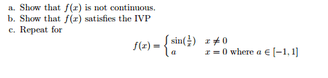

Here is the given problem
a. For part a, I felt it was not continuous because of the sin(1/x) as it gets closer to 0, the graph switches between 1 and -1. Then I felt it might be continuous, therefore I am not sure.
b. For part b, I felt it has the Intermediate Value Property (IVP), because I can do something with the IVT. Those were my thoughts and ideas.
Can you show that the limit as approached positively is different from that as approached negatively? Or that it's different than f(0)? So in other words,
##\lim_{x \to 0} f(x) \neq f(0)##?
For b, I'm not really sure. I thought one of the requirements was that f(x) was continuous...

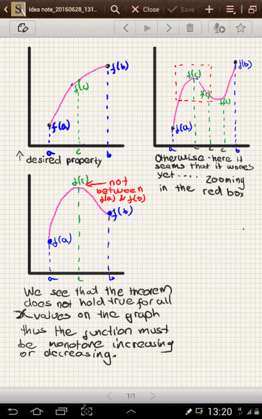

For part a you would have to do what BiGyElLoWhAt suggested. For b I believe you would have to prove that the function in either monotone increasing or decreasing. IVP says that for any x value between two other x values, the y value will be in between the y values for the other two x values.
IVP theorem
JasMath33 said:
View attachment 102545'
If there exist sequences [itex]x_n[/itex] and [itex]y_n[/itex] such that [itex]\lim_{n \to \infty} x_n = \lim_{n \to \infty} y_n = 0[/itex] but [itex]\lim_{n \to \infty} f(x_n) \neq \lim_{n \to \infty} f(y_n)[/itex] then [itex]f[/itex] is not continuous at zero.
