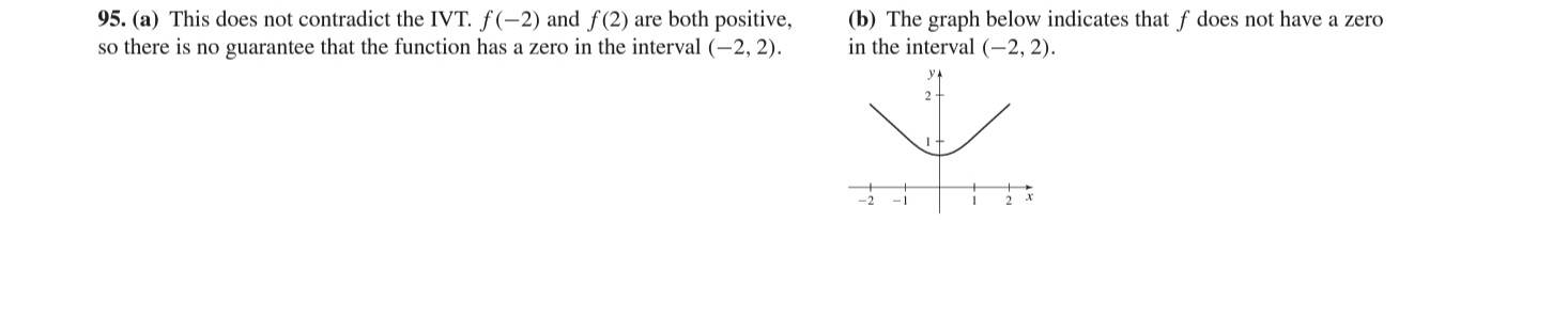

However, the textbook answer is different.
Textbook Answer:
"This does not contradict the IVT. f (−2) and f (2) are both positive, so there is no guarantee that the function has a zero in the interval (−2, 2)."

On the contrary the textbook answer is giving the part of YOUR answer that is important! you said "both are positive". The other part of what you said "both answers are the same value" is not important. What if both answers had been 0?

I don't know what you mean by "both answers are 0". The answer to the question is NOT a number, it is an explanation, a sentence. And both you and the textbook say that the explanation is that "both f(2) and f(-2) are positive"- 0 is not between them.
An important point is that this does NOT tell us that there is no zero between -2 and 2. The intermediate value theorem says that IF f(a) is negative and f(b) is positive then there is a zero between a and b. It says nothing at all about what happens if f(a) and f(b) are both positive or both negative. There might be a zero between a and b or there might not.
